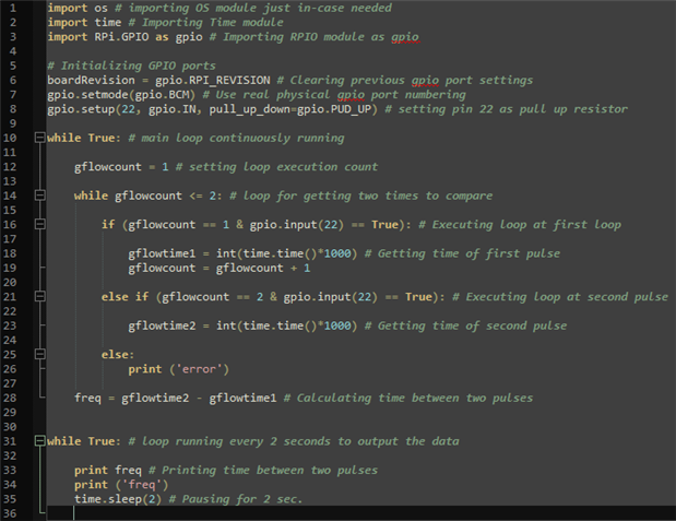

    Which prints out the Temperature data every second but my big problem is figuring out how to count the pulses of the flow meter or to count the time between the pulses to get the frequency. That is the part of the program that i need big help with.
    Using Python
    I have tried this code but i'm doing something wrong it seems.

    import os # importing OS module just in-case needed
    import time # Importing Time module
    import RPi.GPIO as gpio # Importing RPIO module as gpio
    # Initializing GPIO ports
    boardRevision = gpio.RPI_REVISION # Clearing previous gpio port settings
    gpio.setmode(gpio.BCM) # Use real physical gpio port numbering
    gpio.setup(22, gpio.IN, pull_up_down=gpio.PUD_UP) # setting pin 22 as pull up resistor
    while True: # main loop continuously running
      gflowcount = 1 # setting loop execution count
      while gflowcount <= 2: # loop for getting two times to compare
      if (gflowcount == 1 & gpio.input(22) == True): # Executing loop at first loop
      gflowtime1 = int(time.time()*1000) # Getting time of first pulse
      gflowcount = gflowcount + 1
      else if (gflowcount == 2 & gpio.input(22) == True): # Executing loop at second pulse
      gflowtime2 = int(time.time()*1000) # Getting time of second pulse
      else:
      print ('error')
      freq = gflowtime2 - gflowtime1 # Calculating time between two pulses
      hertz = 1000.0000 / freq # Calculating frequency
      flow = hertz / (60 * 7.5) # L/S # Calculating L/S
    while True: # loop running every 2 seconds to output the data
      print freq # Printing time between two pulses
      print ('time between two pulse')
      print hertz # printing the frequency
      print ('frequency')
      print flow # Printing L/S
      print ('L/S')
      time.sleep(2) # Pausing for 2 sec.

    What is the problem with this second code ?
    The indentation is lost when pasting code here, and unfortunately it's hard to follow unindented Python code.
    0 e14 Contributor over 12 years ago in reply to iagorubio
    I do apologize, I didn't realize that copy and paste messed with the indentation.
    the problem is that only output i see to the screen is the 'error' instead of seeing the frequency. If i can get the frequency i should be able to make it work with that.

    Perhaps you want 'and' rather than '&'.  The latter is doing a bitwise AND where I think you want a logical AND?
    Regards,
    Martyn
  • iagorubio
    0 iagorubio over 12 years ago in reply to e14 Contributor
    I think martyndavies hit the nail on the head.
    try with :
      if( (gflowcount == 1) and (gpio.input(22) == True) ):
    The same in the next if statement.
    else if( (gflowcount == 2) and (gpio.input(22) == True) ):
    In other languages - C, Java, ... - the logical AND is written "&&".
    May be that's what caused that error.

    0 e14 Contributor over 12 years ago in reply to e14 Contributor
    no that was just another test program not working properly.
    the program below is the that i'm using at the moment.
    it first checks to see if there is a flow or not. if there is no flow then it returns zero. if there flow then it returns the instantaneous flow rate by looking at the pulses that the flow meter is putting out but if the flow stops before there is enough data to be able to calculate the flow then it will return zero. from there you can take those data points and plot them on excel and figure out the area under the curve to get your total flow from starting to stop and for how long it stopped also.
    gpio.setup(25, gpio.IN, pull_up_down=gpio.PUD_UP) # setting pin 22 as pull up resistor
    def glycolFlow():
      glycolCurrentTime = int(time.time())
      glycolErrorStopTime = glycolCurrentTime + 1
      glycolTimingPulse = 0
      while glycolCurrentTime <= glycolErrorStopTime:
           if gpio.input(25) == True:
                if gpio.input(25) == False:
                     glycolTimingPulse += 1
                else:
           else:
      if glycolTimingPulse != 0:
           glycolStartTime = int(time.time())
           print 'glycol start time', glycolStartTime
           waitTimerglycol = glycolStartTime + 2
           waitTimerCountglycol = int(time.time())
           glycolCount = 0
           print 'glycol count', glycolCount
           while (glycolCount < 15) and (waitTimerCountglycol <= waitTimerglycol) :
                          glycolCount += 1
                          waitTimerglycol = int(time.time()) + 1
                     else:
                else:
          glycolEndTime = int(time.time())
           print 'glycol end time', glycolEndTime
           if glycolCount == 15:
                glycolSecsPerLiters = glycolEndTime - glycolStartTime
                glycolLitersPerHour = (3600.0 / glycolSecsPerLiters) * 30
                glycolGalPerHour = glycolLitersPerHour * 0.26417205235815
                return glycolGalPerHour
           else:
                glycolGalPerHour = 0
      else:
    while True:
      glycolGalPerHour = glycolFlow()
      print "glycol flow =", glycolGalPerHour, "Gal/Hour"
