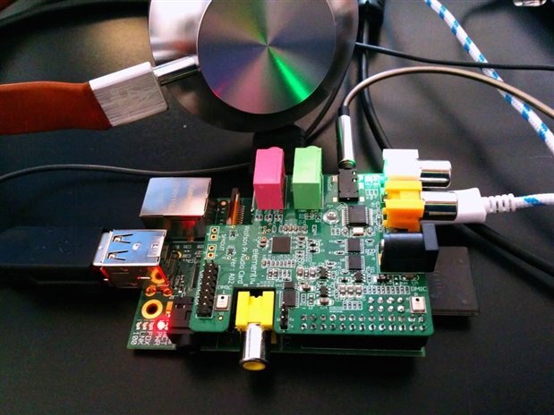

    Wolfson Audio Card at work:

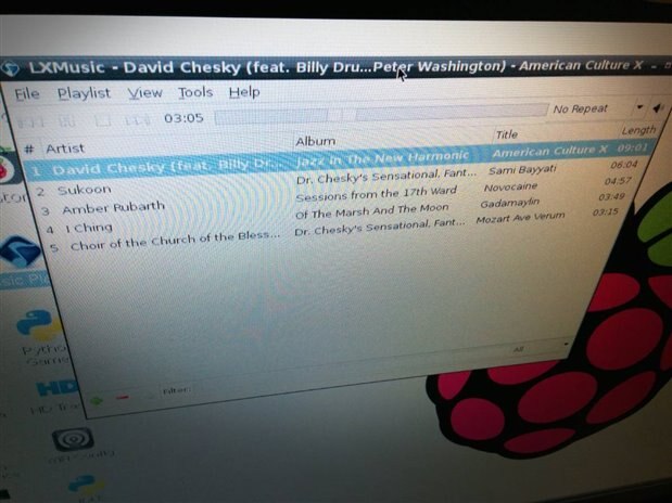

    I burned the patched image to an SD card, booted from it and went through the Raspbian set-up procedure.
    Rebooted and... It works image There is sound from the Wolfson card!

    Note: this is the stock Raspbian image, except for the kernel. The music player and extra programs needed are not installed.
    sudo apt-get install lxmusic xmms2 xmms2-plugin-all volumeicon-alsa mpg123 mplayer
