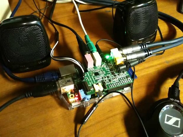

If it isn't already apparent I don't particularly know what I'm doing and the manual was little help pointing only to .1" headers, I assumed you would want something like a 2 pin terminal block which apparently are pretty rare in 2.54mm. Am I just missing a really easy way to connect speakers and use the amplifier?
    0 e14 Contributor over 12 years ago
    I usually buy 40-pin breakaway headers like these https://www.sparkfun.com/products/116 and just snip off the length I need.
    Ragnar
    0 e14 Contributor over 12 years ago in reply to e14 Contributor
    Would you then put female ends on the speaker wire?
    Yes. For the small speakers  I have connected now, I cut a couple of female-to-female  Dupont cables in half and soldered them to the speaker wires.
