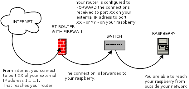

I am sure this has been answered but I cannot find it!
I have set-up a security camera with a PIR and it captures a short video and also emails me a low res. pic when activated. What I would like to do is go and look at the video whilst I am away.
The Pi is networked to my BT router but the house PC's are not on-line.
How can I get to look at the video on the Pi from, say, my phone whilst out camping?

    This have little to do with Raspberry really, as it's just a networking problem.

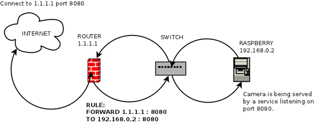

    What you have to do is to forward on your router, one port to the raspberry Pi camera port.
    This greatly depends on your router and service provider.
    A graphic explanation would be as follows:
    If you put it down to network topology:
    Of course IPs and ports will have to match your network ones.
    That have some issues:
    • It's a security risk. You would need to sort out encryption and authoritation on your raspberry before to start.
    • The IPs must be static in both your router and your raspberry. In your router you can set a free no-ip dynamic DNS account to fix it - Free Dynamic DNS - Managed DNS - Managed Email - Domain Registration - No-IP - but on your Raspberry you will need to configure the network interface by hand and avoid to use DHCP.
    Other than that, this is easily doable.

    Reading your question again, is not that clear your camera is connected and being served by your Pi.
    Can you connect to your raspberry on your internal network and see the camera's image ?
    If not, that would be your first step.
    On the other hand, as you mentioned BT, a quick search returned this page about how to configure port forwarding on BT routers http://bt.custhelp.com/app/answers/detail/a_id/8790/~/does-the-bt-home-hub-allow-game-and-application-sharing%2Fport-forwarding%3F

    0 e14 Contributor over 12 years ago in reply to iagorubio
    The pi has the piCamera on it and a PIR device and works well and can be 'seen' by my in-house PC. It will be running stand-alone normally.
    OK, thanks, I will look into doing this tonight.
