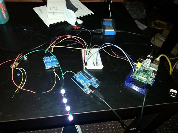

    I have taken a picture of the crude setup I have right now at my girlfriends house. Once I get home I will have another strip of 4 soldered up and then setup on my 3D printer to illuminate the bed. image
    I apologise about the mess..
    My setup:
    My Raspberry Pi controls both an Arduino and an Opto-Isolated relay board.
    The purpose of this setup is so the Raspberry Pi can control a slave Arduino which sends the data to the LEDs and also switches the contacts on both channels of the relay board. The WS2812B chip +ve and -ve leads are attached to an external 5v 2A supply to prevent power problems. The power supply is fed through the relay so that the LEDs can be turned on and off via simple shell scripts executed on the Raspberry Pi. This setup is also useful because I can reprogram the Arduino through the Ino software package on the Raspberry Pi via the command line without the need for unplugging anything. This is the exact setup that I was after (though in a crude layout right now). The second relay on the relay board will be utilised as a shell controlled On/Off switch for my printer once I get home and find some 16A wire.
