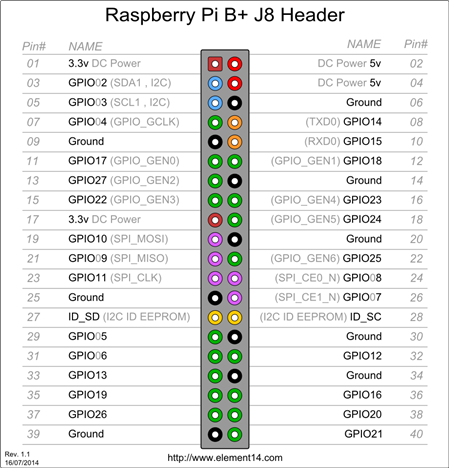

    Not a schematic but something, here's the pin ut of the new 40 pin B+ expansion connector
