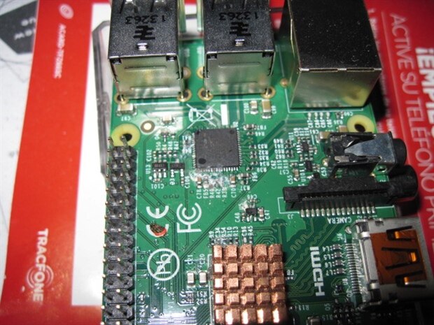

I mounted a heatsink that I got with my Mod B Complete from Prestige Milano,
on my NEW ModelB+. (from Pi Hut)
The B+ worked for 3 weeks then just QUIT. Looking that the board, I see
corrosion on the pins of second big chip. I took the Prestige Milano heatsink off.
Looks like ACIDS from the doublesided tape ate the leads of the chip.
Grrr...image
    0 shabaz over 11 years ago
    On a normal RPI board there is nothing else that could cause this blemish, so it's possible that the sticky tape wasn't intended for heatsink use.
    Anyway, that part isn't intended to be heat sinked by the designers of the RPI so unless you have a heatsink which has no risk of touching the edges (that's a QFN chip so higher risk than BGA) and used the correct tape specified by the heatsink manufacturer, then there could be a risk for these things to occur. I'd try and get a replacement RPI (or compensation for a replacement) from the company that sold you the heatsink+tape, if they claimed it was intended for the RPI. It's product liability - they are responsible for any damage their product causes if the product was used as intended. This assumes you used the heatsink+tape product as described in their instructions.

    0 skipf over 11 years ago in reply to shabaz
    It was just a bag of heatsinks that came along with my Mod. B... I had some copper VRAM HSs that fit the CPU BETTER,
    they also had a different TAPE, marked 3M... The aluminum HSs from the Mod B were slightly smaller, so I decided to use one.
    They used an unbranded CLEAR tape.

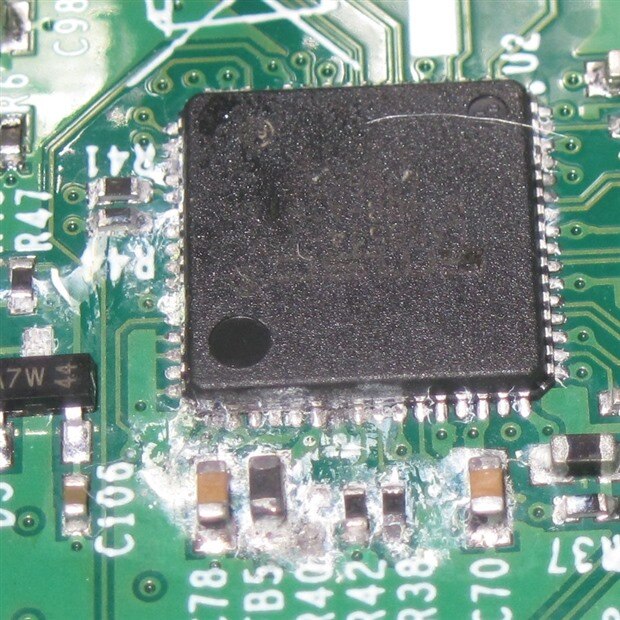

    Could you please post a more zoomed in picture of the actual damage, it might be possible to save your pi if only a few legs are mildly damaged. Also can you please clean the area around the chip, taking care not to cause damage.
    0 e14 Contributor over 11 years ago in reply to kidiccurus
    definitely try cleaning it to get rid of all residue (that could be whats causing it). Also don't power your pi up until you are certain that you have done everything possible, the last thing you want is some sort of dead short.

    I'm going to wait for some Kester flux remover, and Liquid Flux and try to 're-drag' the affected area. I tried to photograph the area again,
    but even with my BeloMo x10 triplet, it's hard to see the damage. I've used a USB E/I Display since Day One and the board NEVER
    drew more than 680mA., while running a USB SDR RX and Dump1090. And this B+ is 5 to 7°C cooler than my B board.
    Now the board settles down to 370mA; BOTH LEDs are OFF AND U2 is 21°C while U1 is 27°C. They USED to run around
    35C, with a heatsink.

    That picture is great. Can you take a second one when you have cleaned it.
