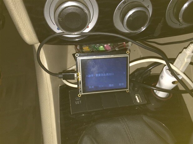

I tried to disabled sieral & UART in order to use LIRC with GPIO15 instead of GPIO18(P1-10 instead of P1-12).
I succed when i do not connect with wolfson,but when i pluged wolfson in to Rpi and powered Rpi
I got an error。
Can anybody give me a method to use LIRC WIth Raspberrypi & Wolfson?
left:Wolfson Audio Card With Raspberry PI model A and mobile charger
I have configed rpi with Volumio 1.4 ,i can control it with my mobile phone,but i wann to control it with IR Remote control,because of i want to use the wolfson card in my Car)
Who can give me an advice?Many Thanks!
right:my X-pi(Raspberry PI model B and 2.8“Tft Screen and Rpi Camera model and LI-Po battery)

    Be sure you also configure the lirc output pin to use gpio 14, otherwise it will use gpio 17 by default which conflicts with the wolfson card.
    Your /etc/modprobe.d/lirc.conf file should look like this:
    options lirc_rpi gpio_out_pin=14 gpio_in_pin=15
    I'm using this config for several months now, and both the wolfson card and my IR receiver work fine with my OpenELEC test-builds.

    You might also check that the GPIO 14 and 15 are not occupied by the TTY. I use a patched ArchLinux and it needs a small change in the /boot/cmdline.txt (removing all parts pointing to ttyAMA0); other distributions might need some more changes (> grep -r "ttyAMA0' /etc/* to find possible candidates).
