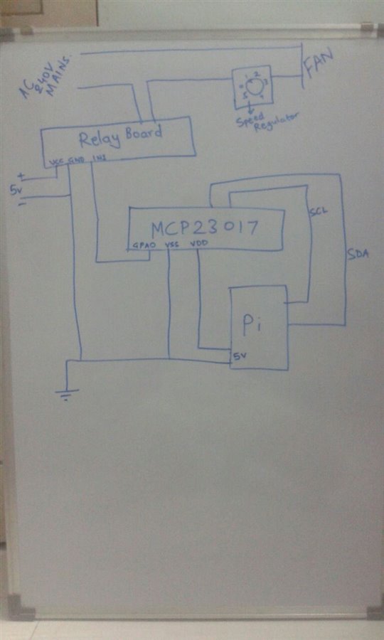

Hello,
I have attached AC fan as load to my SainSmart 8 Channel DC 5V Relay Module.
The relay board is supplied with external power supply(5V,1Amp).The relay board is controlled by MCP23017(gpio expander ic connected to my raspberry pi).
The fan is with Regulator.Sometimes when i change speed from regulator the ic is reset and relays stop working.

    Could you clarify your explanation of the circuit setup. You mention an AC fan but how are you powering the AC Fan. I guess the most likely cause of the problem is a voltage spike or voltage dip is pulsing your power feed to the logic circuitry. This in turn causes the logic circuitry to reset. Usually you can protect yourself from this by using decoupling capacitors on the power rails or by isolating the power supply to the logic circuitry from the power management circuitry.

    Sounds very much like it John, I assume it's some kind of speed controller rather than a regulator as such. If so and it switches at any old time rather than say at zero crossing the spikes could indeed be quite large however it's amazing it does this considering those relay modules also have opto isolation and he's using a different power supply.
    Nilay can you lay out your circuit diagram so we can see it ...cheers

    Hi Nilay, I see nothing intrinsically wrong with your layout. The fan may be creating enough of a spike when the speed changes to affect the house mains. Depending on the sophistication of your 5 volt supplies this spike may be getting through. Try putting 100 uF caps across the Vdd - Vss on the Pi and MCP23017. The only other possible situation is if the Pi and MCP boards are very close to the 240 volt power feed to the AC we might be getting some inductive coupling.

    Not much extra can be said John's pretty said it all.
    Power the PI and Relay board off a different socket than the load (fan)
    Decoupling as John  stated previously
    keep the circuitry as close together as possible with SHORT wires
    If you have access to another fan controller maybe use this

    just a doubt, the spikes that i observe are bcoz of the speed regulator from relays reseting the ic .so why to set up the capacitor between pi and ic and not between relays and ic ?
    0 jw0752 over 11 years ago in reply to e14 Contributor
    Hi Nilay, The capacitors should go between the power rails, as close to the boards as possible. Watch the polarity. I sugested one capacitor between the power rails for the Pi and one capacitor between the rails of the MCP as they are the most susceptible to spikes. You did indicate that it was the MCP that was resetting. Give it a try and if it doesn't solve the problem let us know. John Alexander is following this thread too and he is actually a lot more knowledgeable than me and he will let us know if there are better options to try.

    It's hard to be sure but another possibility to look for is that the regulator is opening and closing the mains circuit causing large very high frequency transients. If you set up the fan and regulator not connected to your relays but with the wires physically close does it still affect the rest of the circuit ? If it does then you will need to do something about the regulator but I'm not quite sure what (without knowing what is inside it.) If the problem only occurs with everything connected you could try winding the two wires GND and GPA0 from the MCP32017 to the relay board several times round a ferrite lump (like Farnell 2364660).

    I dont think its just the regulator thats creating the problem. As even when i switch fan relay on off in succession there is the same effect as of regulator that is resetting of mcp. Also i would like to mention its only the fan that resets the mcp and not other appliances connected to relays like lights or switch sockets .
