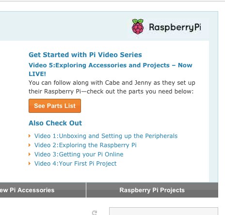

    0 gadget.iom over 11 years ago
    I would strongly suggest you look at The specified item was not found..
    There are links to videos on the homepage that may help you.
    0 shabaz over 11 years ago in reply to gadget.iom
    I'd forgotten about that video series, but I remember it now. It really is very good.
