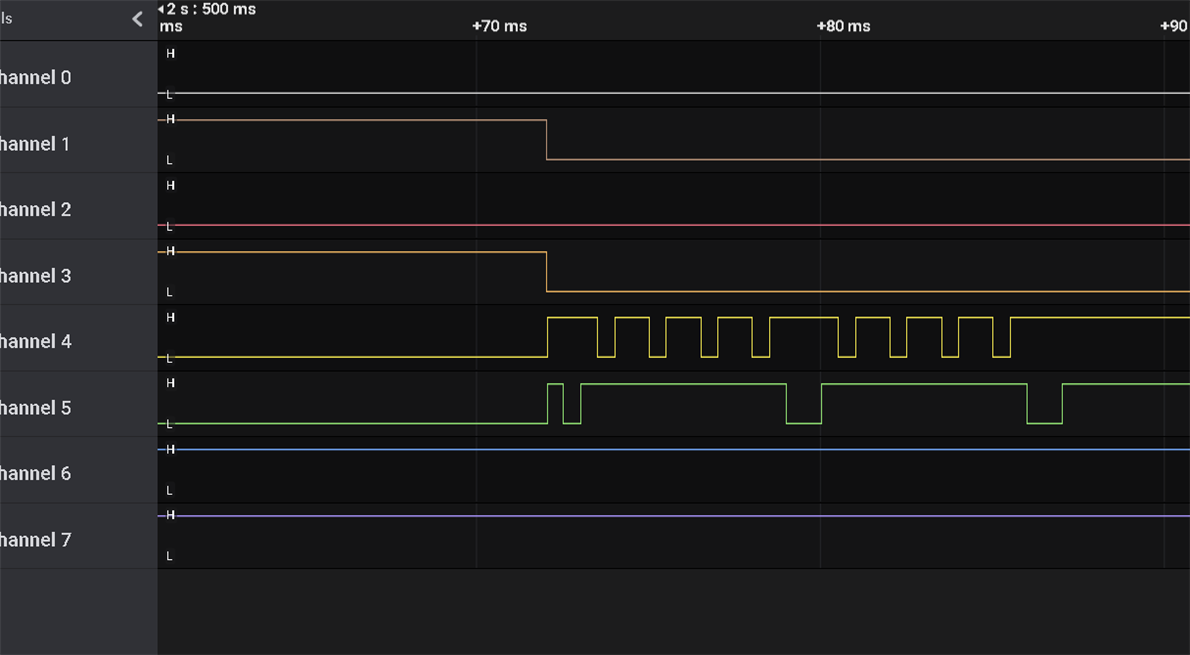

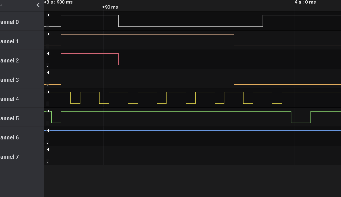

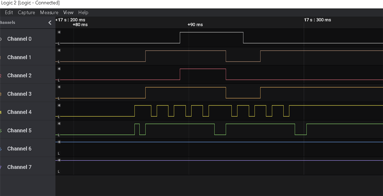

    I'm programming a 16bits to 4bits comm protocol...  4 bits of data, a DEN (data enable) and a CS (chip select. )  It's just for check RP2040's capability.
    import array, time
    from machine import Pin
    import rp2
    #protocolo de conversion de 16bit a 4bit (en 4 tramos con una salida de DEN (data enable) franco bajada
    # y EN en positivo.)
    @rp2.asm_pio(out_init = [rp2.PIO.OUT_LOW] * 4,
                 sideset_init = [rp2.PIO.OUT_HIGH] * 2,
                 out_shiftdir = rp2.PIO.SHIFT_LEFT,
                 autopull = True, pull_thresh = 16)
    def pioNiple():
       set(x, 3)      .side(0b01)
       label("loop")
       out(pins, 4)   .side(0b11)
       nop()          .side(0b10)
       jmp(x_dec, "loop") .side(0b11)
       nop()          .side(0b01)
    sm = rp2.StateMachine(0, pioNiple, freq=2000,
                          sideset_base = Pin(14),
                          out_base = Pin(10))
    # Start the StateMachine, it will wait for data on its FIFO.
    sm.active(1)
    sm.put(0xFFAA)
    sm.put(0xAA01)
    This is when I use shift_left  Channel 0..3 bit 0..3  channel 4 is DEN and channel 5 is CS.
    shiftleft
    When I use Shift_right, It works perfectly.
    shift_right

    YES!!!  YOU'RE RIGHT!!!
    It works fine if I make shift 16bit before using sm.put.
    I can avoid having to do shift in sm.put change pio.asm code for 32bit instead of 16bit,
