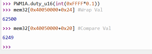

    I suspect you are likely just missing the conversion to int:
    I don't know why they don't support floats as inputs, the whole point of using python is to make it easy!

    robogary over 4 years ago in reply to shabaz
    ROFL - thanks, what I discovered was just exactly what you replied !
    Python didnt care about distinctly defining a u16 word. It just took the float value and converted to INT.
    The PWM duty command says its needs a u16, but if the value is lower than 32767, it really doesnt care what it is.
    As long as the INT value is below 65535 all is well .  Sometimes I overthink these things and force it too much like C coding.

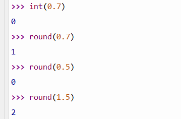

  • scottiebabe
    scottiebabe over 4 years ago in reply to scottiebabe
    Converting from float to int with the int() function may not be a good habit to have, as I recently discovered with spurs in my DDS lookup table.
    The int() converts from floating point to integer via truncation and round converts with its own set of rounding rules.
