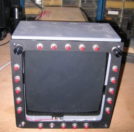

    My first dive into cap senors was with TIs msp430 and the Cap sense kit works neet I will most likely use it for my Computer Display buttons https://www.ti.com/lit/an/slaa842b/slaa842b.pdf?ts=1657658396233&ref_url=https%253A%252F%252Fsearch.becovi.com%252F  https://media.digikey.com/pdf/Data%20Sheets/Texas%20Instruments%20PDFs/.430Boost_Sense1_Cap_Touch.pdf
    imageAND  its easy to program! you use C with Eclipse

    imageyes!!  I will drive 20 tabs with it, for my new PLA bezel (not shown)
