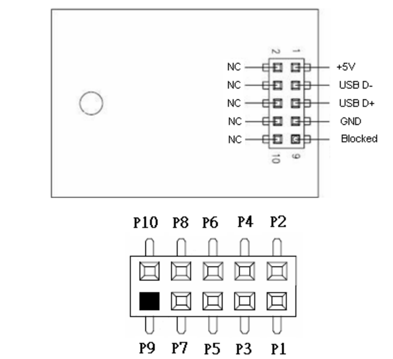

    shabaz over 3 years ago in reply to cstanton
    There's a standard for that : )
    image (image sources: google images)
    It's normally for embedded/on-board USB Flash (might be called eUSB, I can't recall), but I think it should be fine for anything.
    There's another smaller connector standard too, but this is the 0.1" header one.

    baldengineer over 3 years ago in reply to shabaz
    Lol, nice. I think the design challenge is how to incorporate the functionality without changing the existing GPIO.
    Not unsolvable, but not trivial either.

    Gough Lui over 3 years ago in reply to shabaz
    They just borrowed that from the standard USB 2.0 front-panel pinouts on most motherboards ... but ignored the second USB port, leaving them all N/C. Not highly efficient, but can work ...
    That being said, different variants of the M.2 socket can also carry USB ...
