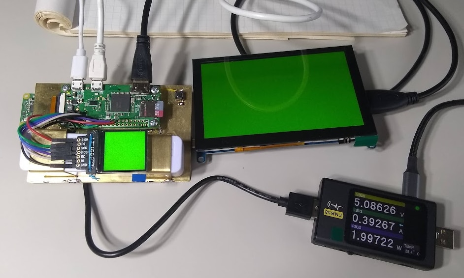

    scottiebabe over 3 years ago
    Fire Now were cooking! Fire
    I am able to write directly to the linux framebuffer in python.
    fb = np.memmap('/dev/fb0', dtype='uint8',mode='w+', shape=(480,800,4))
    fb[:] = [0,255,0,255]
    So hopefully with a firmware upgrade I will be able to unlock the spicy fries or scallop potatoes mode
    In this example I am having https://github.com/juj/fbcp-ili9341 drive the SPI display.
    I should note that if your are using x-windows or an hdmi/dsi display the libcamera preview functionality just works.
