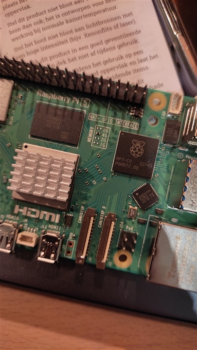

  • Hi everyone, i'm french. I bought three weeks ago an rpi5. I tried for a long day to boot the rpi5 wirh no succes. The led flash green ( 4 slow flash and 3 Quick flash). I found on the raspberry website that it IS a fatal error : RP1 not found. I found similar issue on other forum and it seems that there some composants missing. Someone Ask to look for missing composant or scratch around the rp1 chip. On their photo, we Can see little resistors missing. So i looked on my board and it is the same.
  • So i have contacted Farnell to have a return number. They Saïd I Ask my manager several Times but Steel no answers. And now they don't respond any of my request. What Can i do ? I 'm so disapointed.imageimage

    That's disappointing, sorry to hear that. Those would be PCIe AC coupling capacitors:
    Hopefully, someone can help you find out who to connect with to remedy the issue.

    On the other hand, this looks like an interesting fix for someone with a fine soldering iron and a steady hand!
    It's difficult to tell from your photo, but it could be that something hit this part of the board after production and dislodged the capacitors. Actually, looking at the second photo maybe they were never placed during manufacture. The pads have a smooth blob of solder and look undamaged.

    Yes, i think it's factory default.
