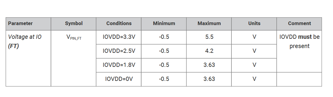

    Also, the RP2350 has 5 volt tolerant I/O, when IOVDD is run at 3.3 volt.
  • aswinvenu
    aswinvenu over 1 year ago in reply to baldengineer
    Okay! I got confused. RP Pico and RP Pico2 are compatible! Not the SoCs. Thanks!
