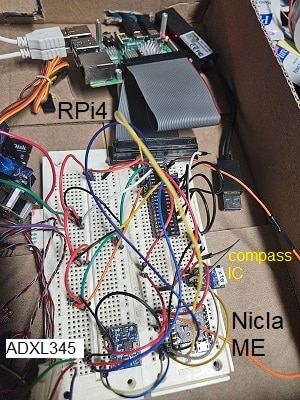

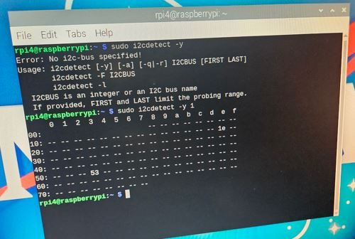

    To make sure a valid check, I wired in two more i2c sensors to the RPI4 i2Cbus with known i2c bus address (on stickers) from a previous project, a compass sensor (x1e) and an ADXL345  3 axis accelerometer/gyro (x53)
    image     image
    so......i2C doesnt see Nicla -----> more work to do,

    I retry the RPi i2c detect, still no x28.
