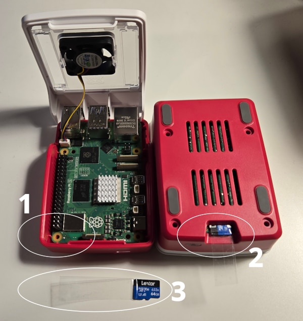

How do you overcome the limited access to the SD card on Raspberry Pi case that is physically mounted to a surface?
Lately, I've deployed a number of Raspberry Pi in the company network. They are ideal for network UPS monitoring [NUT] servers and ad block pi-hole servers.
A power failure last Friday corrupted a memory card in one of the Pi's. Restoring the OS image got the Pi working. The pi are mounted to a wall using the mounting holes (Ellipse 1). In order to get at the memory card (Ellipse 2) I have had to unmount the case from the wall. My fingers are just not small enough and I haven't discovered a tool that can grip the card in such a small space with the case mounted to a surface.

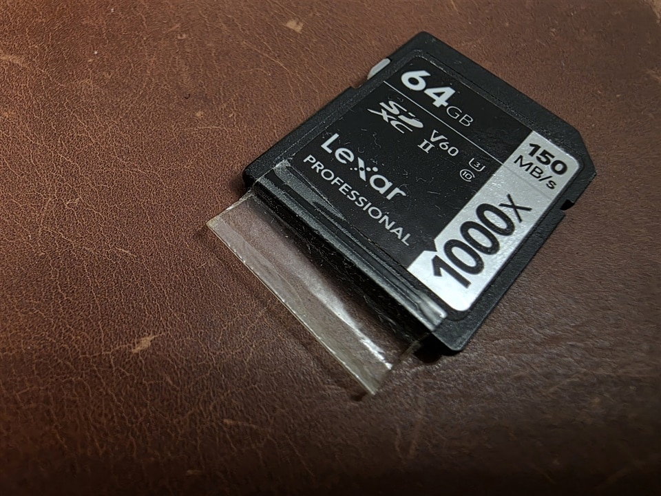

The picture is of a new case I am trying. It suffers from the same problem as others. On a different case I've taken to cutting the plastic around the SD card to enlarge the hole. It looks like crap but works. Recently I've taken to extending a handle on the SD card with cellophane tape (Ellipse 3). Removing the SD card without having to unmount the case is possible by pulling on the tape handle. Getting the SD card back into the unit is a bit of a challenge.
I've struggled with SD card insertion on a Pi3B+ case I had mounted to my workspace. It took a pair of needle nose players and some wrist flexing to extract cards.
Please share your insight if you think it can help solve the case.

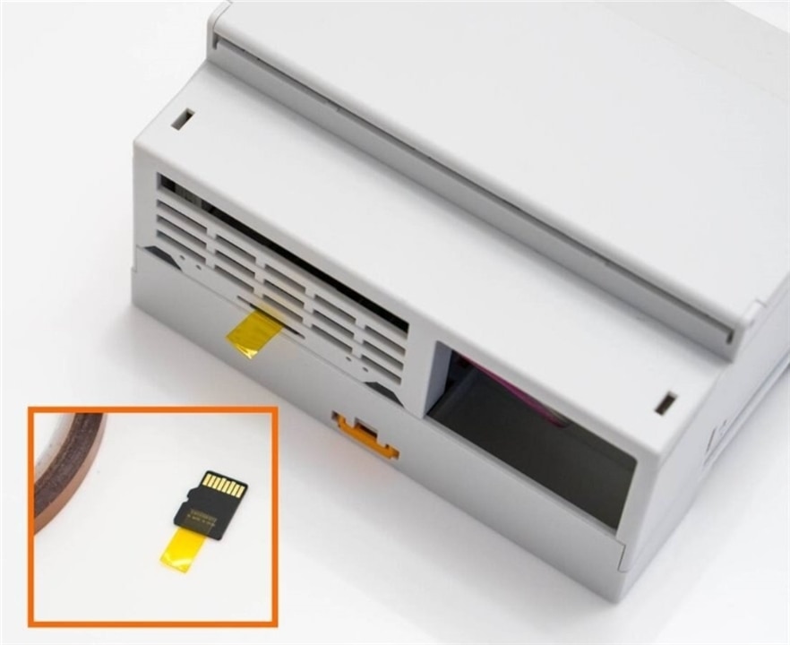

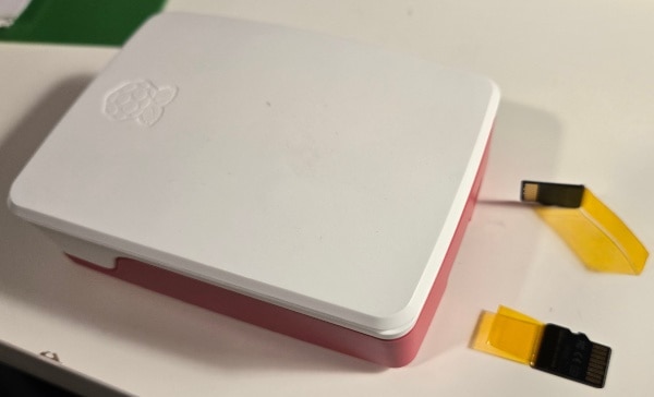

    Amazon delivered today Bomei Polyimide Tape https://www.amazon.ca/dp/B08Y8L2W6D?ref=ppx_yo2ov_dt_b_fed_asin_title&th=1 It is what Amazon search returns if you are looking for Kaptop tape, the productShabaz suggested.
    I purchased 10mm width rools. My calipers measure 11mm on the width of the SD card had sitting on the bench.
    Folded the tape to form a pull-tab on an SD card. The tape thickness measures .10mm on my caliper where my cellophane tape measure .07mm
    I used some tape to make a few tabs and discovered folded lengths greater than 20mm, not including the portion attached to the card, is ideal for making a right angle fold so the card can be inserted with the Pi case flush against a surface.
    I experimented with a shorter length and that only resulted in new swear words. I confess even with the longer length, the card catches the card holder bracket but it was still a struggle to insert. I need smaller finger to push the card all the way in through the case hole. The tape is a work around. Taking the case off the wall to replace a SD card is a pain.
    Let hope power bumps that take out cards are in short supply.
