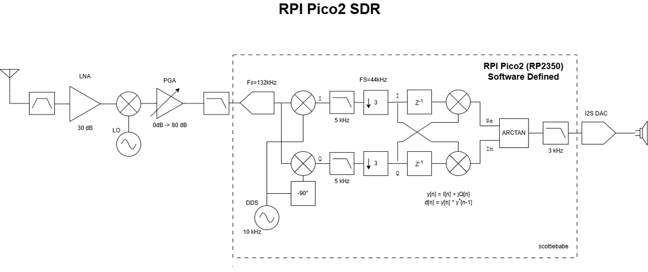

Have been experimenting with implementing an SDR on a RPI Pico 2.
I put together a bare bones SDR for narrowband FM
Diagram created with https://app.diagrams.net/ Source: (remove the .txt extension)/cfs-file/__key/communityserver-discussions-components-files/91/pico2sdr.drawio.txt
The input is IF is oversampled, frequency translated to baseband, filtered, and then decimated by a factor of 3. A polar discriminator demodulates the narrow FM signal and is low-pass filtered and output to an I2S DAC.

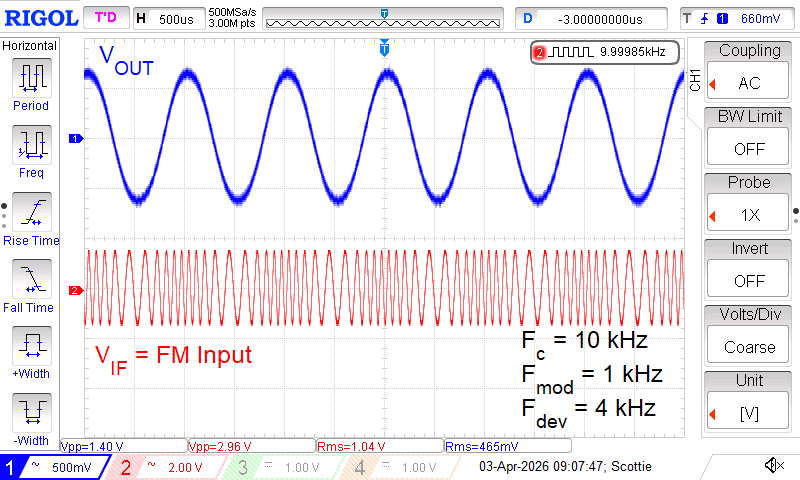

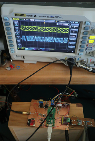

As a first test I am applying a narrowband FM signal directly to the ADC input of the pico2
The I2S DAC I used has a class-d BTL output. I had to add an LC filter to the output for the scope to display the audio output and not the class-d pulse train.

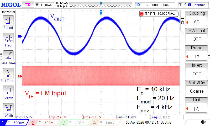

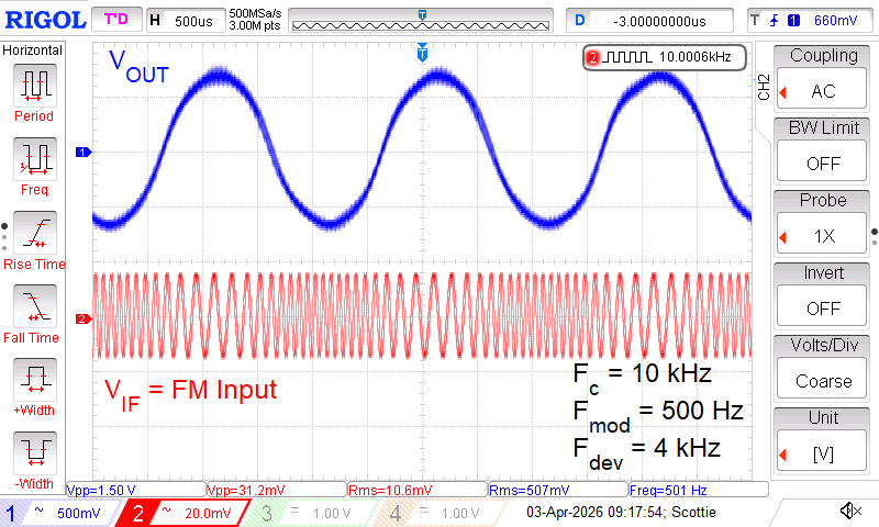

A few different input signals and demodulated output shown on my o-scope
When the input is below 10 mVpp the SDR starts to struggle.
The output amplitude is a function of the frequency deviation, not the input amplitude.
Pretty cool.

    Impressive.  Just so I am on the right track, the blocks depicted within the dotted lines and labeled "RPI Pico2 Software Defined" are all implemented as code being run on the Pico2?

    shabaz 7 months ago in reply to dang74
    I don't want to pre-empt the actual answer, but generally, yes : ) once it's been ADC'd, all the math can happen internally in code.
