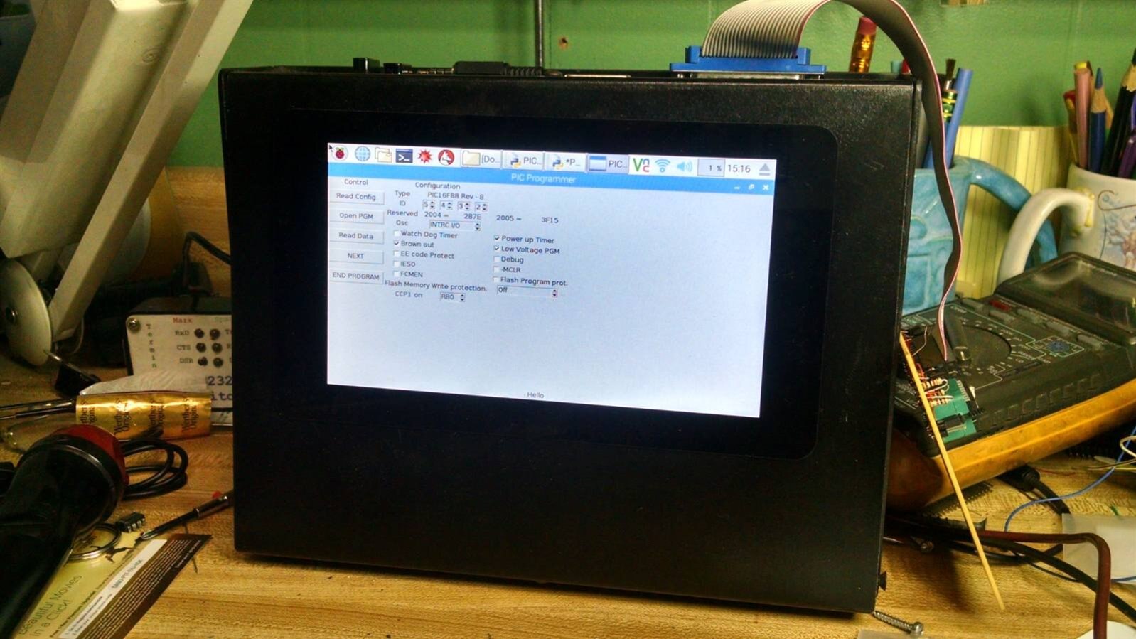

  • wadeelmore
    wadeelmore over 9 years ago in reply to uscdadnyc
    Custom metal enclosure.  Pi2 is mounted to back of the display.  The GPIO pins are extended to a DB25 and DB15 connector on top.
    I am working on putting a battery pack inside the case, making it self contained.
    Please excuse the messy work bench.
    Yes the display works great with Pixel.

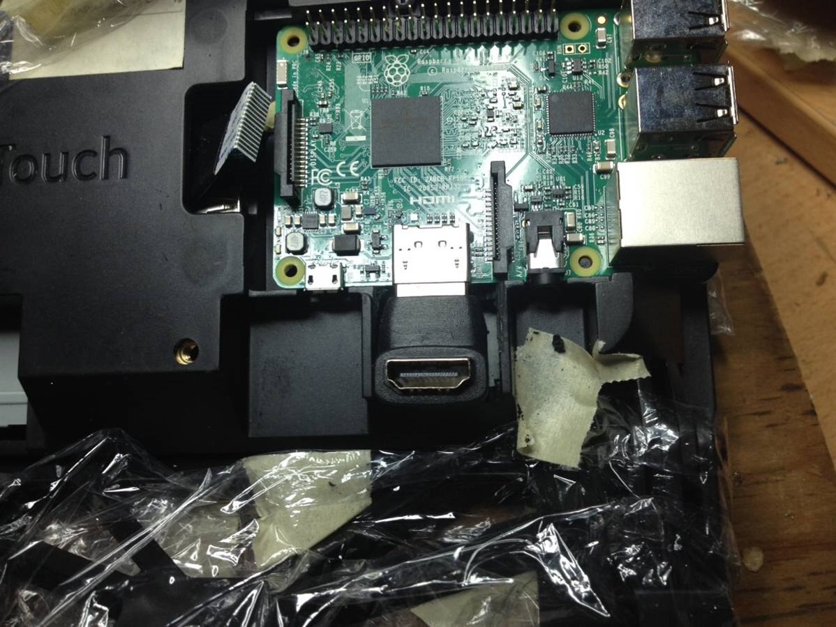

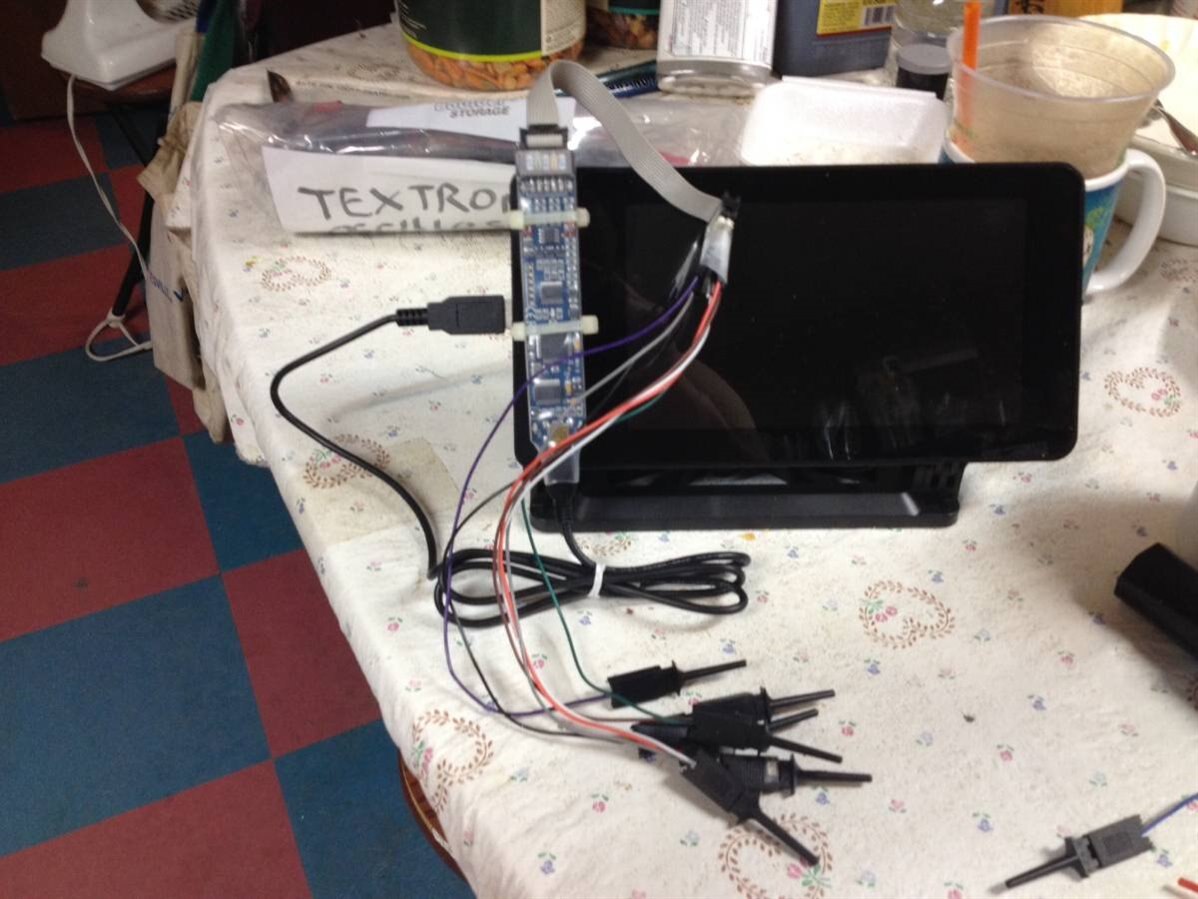

    Like I said I use a SmartiPi Enclosure:
    Pic of my unit assembled. That is a Bitscope USB Oscilloscope mounted on a Lego Brick (i.e. detachable)image

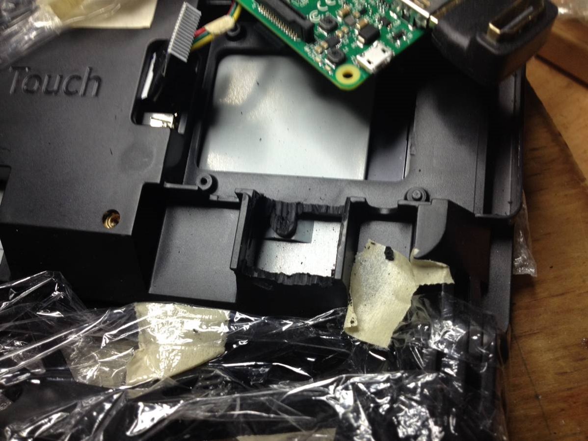

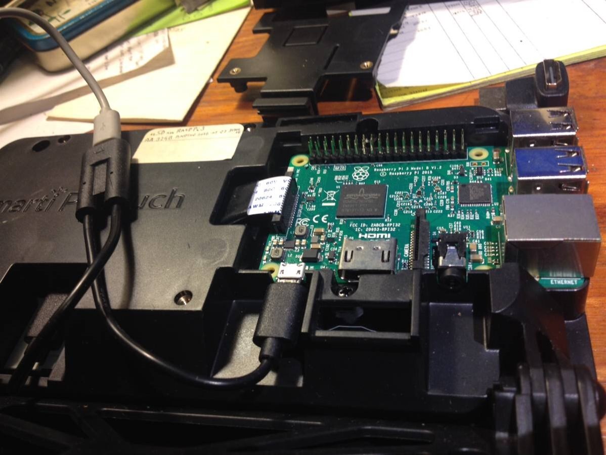

    Pic of the back of the SmartiPi -opened-Up. Note that the HDMI Port is blocked
    Cutaway (using Dremel Tool) to expose the HDMI Port
    RaspPi 3 B in SmartiPi Case and the HDMI-Port-Exposed using A Right-Angle HDMI Adapter
    BTW the SmartiPi Enclosure Back Panel (Not Shown) has an Opening for attaching a 40pin Ribbon
    Cable to the GPIO Pins in the Photo above.
