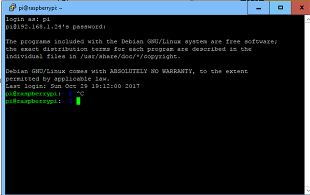

Trying to ftp into my pi
I get this:
STATUS:>    Connecting to 192.168.1.24
STATUS:>    Socket connected. Waiting for welcome message...
    SSH-2.0-OpenSSH_6.7p1 Raspbian-5+deb8u3
then that's about it.
using my pi login info and tried root as well same result. as well as on port 22.
Sure I am pretty sleepy at the moment and still at work so having a huge brain fart anyone able to lead me into the right direction
I am able to ssh into the pi tho.
Any help would be great.  have the pi setup as a webserver at the moment. just would like to use ftp for building a site and testing on the pi.

    Hi Wesley,
    I suppose you are using the SFTP command to connect to the RPi, can I ask what arguments are you using with the command?
    Alternatively, if you only need to copy files across, you can use the SCP command.

    Hi Wesley,
    You seem to be connecting to the SSH port, the one numbered 22.
    That port is used to gain shell access to the pi. FTP is an old fashioned protocol that works on port 21.
    Now when you have shell access you can run a program on both ends and transfer files like that. That's what SFTP, SCP and RSYNC all do.
    So if you're using an old FTP program but adjusting the port number to that of SSH, the program and the server-program will be talking different protocols. That can't work. You could use something like "sftp" or "scp" to copy files across.
    To be honest: I prefer "rsync" (even though it is not installed by default on the pi). When nothing special is going on, I'm just typing two letters more than scp. But when for example a big transfer needs to be stopped and restarted, rsync is way better. The most common case is when I tell rsync to copy a bunch of data but it then starts copying data that don't need copying or can wait for later. So then I abort the transfer and restart while excluding the non-needed data. That's much more efficient when you're using rsync.

    Ya I had sftp setup after I decided I should upgrade my distro since I had not used my pi in a bit....let just say its fresh install time.....arg.  should have made a backup of my microsd card seems it messed up and would boot after tested with another image I had on another card and it booted so was a it of a pain.

    Well that was lame I formated my drive when I didn't have too.    Seems some entries got added to cmdline.txt and would have resolved if I restored it to the origional
    quiet bootmenutimeout=10   root=/dev/sda1
    Oh well think I might try a few different os systems since I have it back to stock on my drive at the moment.
    Currently using berryboot loader
