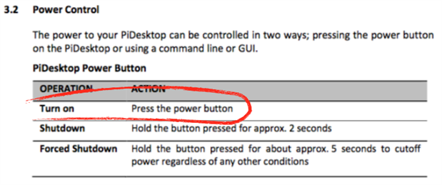

Hi all
I have Raspberry Pi3. I want buy Pi Desktop and connect it with RPI3 and add mSata hard disk SSD. I use it for home automation application. But i have a problem becuase Pi Desktop has own POWER BUTTON. And one problem which i have before buy is that after lost POWER all RPI3+Pi Desktop no start automaticaly when POWER come back. I must click on POWER BUTTON.
Is any chance to configure this to when power lost and when power lost RPI3 worsk , and then when power come back to RPI3 + Pi Desktop start automaticaly ?
Rpi3 without Pi desktop start automatical but power adapter is connected to RPI3 but when use with Pi Desktop powerd adapter is connected to Pi Desktop(and power is transport also to RPI3 by GPIO or USB)
I need have auto start rpi3+pi desktop because it is use for home automation and when it not start auto , when power lost and come back my home automation control stop working. But when i am away home i can not power On it by button.
Please help me.

    And is no any chance to change this to remember last status power? And after lost power automatical start....?
    In normal PC this option is available.

    I use UPS but after ups dead also raspberry power off. And then i must power on manualy( if i use pi desktop)
    But when i connect power plug not for pi desktop but to RPI3 ? Disk mSATA SSD will work ?

    The Pi doesn't have a power button. When you apply power, it boots. You're using an enclosure with circuitry and a power button. If the button works for you, great.
    If it doesn't, at some point you'll have to either
    (a) try it yourself, document precisely (to yourself at least, but you should publish it to help others in a blog post format) and then develop code (scripts perhaps) and some hardware to help you control the Pi in the manner that suits your needs, or
    (b) use a known working design and live with the fact that it isn't precisely what you want unless you experiment and discover how to modify it, or
    (c) - easiest option of all - Bigger battery for your UPS. Simple. Job done!
    There are bits of hardware like SleepyPi that could be used to help you. It requires you to experiment though. If you go this path, please document it to help everyone.
