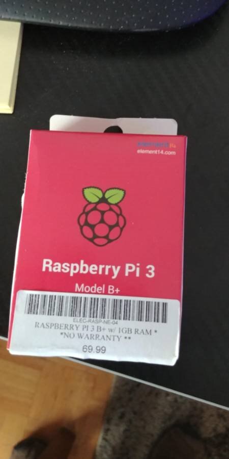

    Hi shabaz ,thank you for your replay,do not understand why the store not handle that but i could make a pic with my phone even they have a sticker on the box NO WARRANTY,when i ask,they told me they do not have warranty because that is only the factory will do.Today i try to call the second store,Canada Robotic what they will tell me.Sorry but here in Canada they took your money wary fast and after that sorry we can do nothing about that.There is any chance to upload the pics from the box?Thank you for your time and replay.

    Hi sabaz thank you again for your replay,today i will go back to the store,and ask about the warranty.That happened 2 times with me,was running the program perfectly for 3 weeks and i remove the power from RPI 10 minute later not start again.Read true 4-5 different forum ask question most of the time they suggested wait for 2-3 day and the Polyfuse will rebuild.Have no clue what is that so i just wait 2-3 day try again nothing happens.Bought 3 different SD card loaded the new Raspberry software nothing helped than somebody in the forum suggested run from USB stick,do not help anything. Funniest thing bought new RPI 3 B+ and i try without SD card and it started no problem.Now is running the program no problem. Unfortunately this is my 3rd PI,(my wife not to happy)and now am happy but i promise to my self not to pull the plug,but sometime we have power outage so i just hope the best.Do not take me wrong love that little RPI but in Canada is not $35  lost one 69.99 plus tax.  Again thank you for your time i do not know ho are you,but thank you     image

    The photo doesn't help (except to highlight, why pay $69CAD for a 'no warranty' product when it costs less new: http://canada.newark.com/raspberry-pi/2773729/sbc-arm-cortex-a53-1gb-sdram/dp/49AC7637
