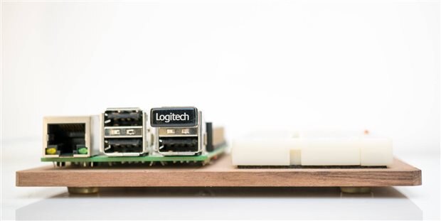

There are enclosures available for the Pi, but perhaps it is better to spend that money on other parts, and build a more practical base for hardware and software development purposes. Access is often required to attach external hardware, and a closed enclosure doesn’t make that practical.
3mm or so thick plastic could make a nice base for the Pi. I used a 4mm thick sheet of wood which was cut and sanded. SpacersSpacers hold it all together, and rubber feet are on the underside. For hardware experiments a breadboard could be attached alongside it. These are just some basic ideas, I'm sure others will have much better tips in this area. The four holes on the Pi are suitable for 2.5 mm diameter threaded hardware. Consider using plastic spacers or stand-offs to prevent accidental electrical shorts to the nearby circuitry. Plastic screws are an option too. In particular, you want to avoid anything metal for the hole nearest the built-in antenna. Metal will de-tune the antenna and will affect its performance. The antenna is close to the hole on the Micro SD card end, closest to the 40-way connector.

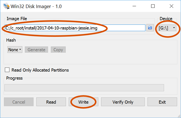

1. Go to raspberrypi.org Downloads->Raspbian (direct link) and download the latest Raspbian image. It is a zip file, so unzip it.
2. Follow the installation guide for Mac/Linux/Windows; for windows, insert a blank microSD card (8GB or higher) and download Win32DiskImager, install it, and then run it and select the unzipped Raspbian file, and click on ‘Write’. It should take about a minute to successfully complete.
