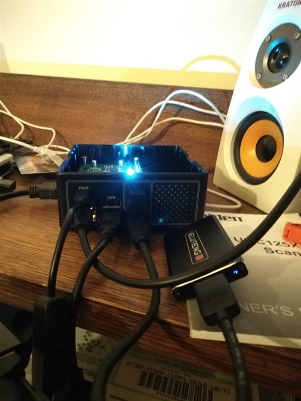

    Hi, Sorry it's taken so long to reply to this - been a bit busy.
    When the Raspberry pi is installed in the Pi Desktop case the original micro usb port that is used to power it is no longer accessible - it cannot be used.
    Instead the daughter board that plugs into the header on the Raspberry pi has two micro usb ports.
    One is now used for the power supply and the other is used to connect to one of the four USB ports on the raspberry pi itself. (top right)
    This makes sense as the daughter board has a physical power on/off button.
    This daughter board also has a mSATA connector as well a a real time clock powered by a coin battery.
    As far as I can see it would not be possible to suplement the power for  the mSata without dispensing with the pi desktop case.
    I have upgraded the PSU to 3.0 amp in any case - but this didn't resolve the problem.
    Curiously this mSATA SSD will work (boot etc) when the caddy is connected directly to the Raspberry pi USB port - which takes it power VIA the daugther board.
    When I then move this SSD to the daughter board itself - the Raspberry pi then resfuses to boot. If it was a power issue, I would have thought that neither should work.
    I'll try and sort out a photo showing this in the next day or so.
    Regards,
    Ian Martin
  • imartin
    imartin over 7 years ago in reply to imartin
    Sorry for the rather poor photo.
    Hopefully you can make out that the power is not direct to the Raspberry pi in this instance but via the add on board.
    To the right you should be able to make out the connector supplied with the case that plugs into the top right USB of the pi and the right most micro usb on the daughter board.
    The other USB cables go to the USB SSD caddy for the mSATA and the Keyboard/Mouse (shared).
