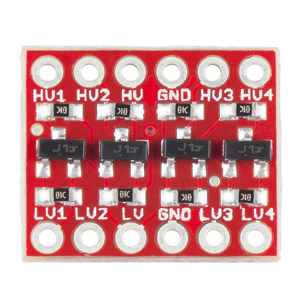

    Thanks for the response. I discovered the issue with the Pi connected to a bi-direction login level converter module. https://cdn.sparkfun.com/datasheets/BreakoutBoards/Logic_Level_Bidirectional.pdf
    My initial reaction was I toasted some GPIO's. After isolating the Pi by removing the converter, I began to see the anomaly I described. Currently the inputs are floating, (i.e. nothing connected) but I will try your resister suggestion and report back.

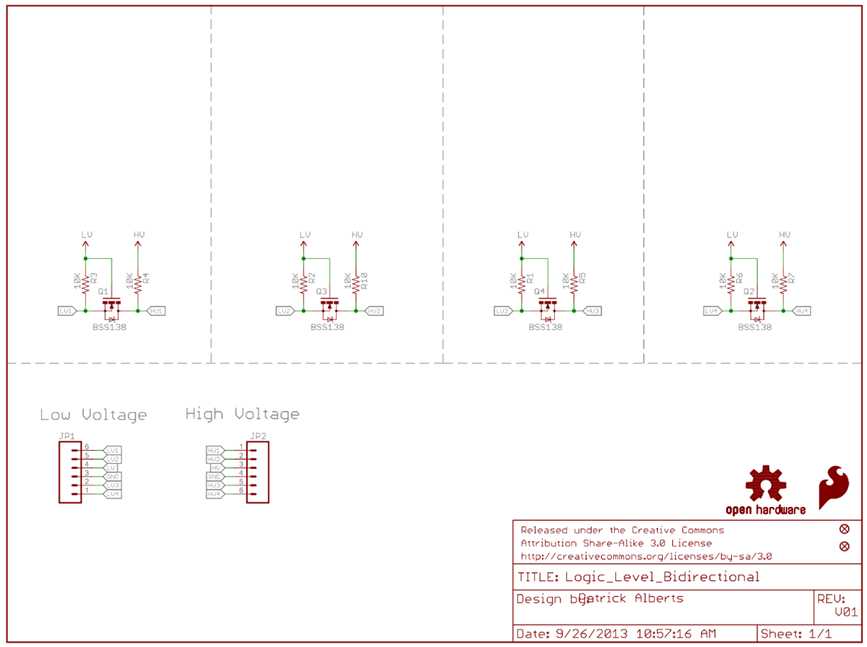

    I believe colporteur was trying to drive a Sparkfun Bi-Directional Logic Level Converter from the GPIO. This is a break-out module with a few FETs on it that is designed to allow you to run protocols like I2C through it, allowing you to intermix 3.3V and 5V logic level devices.

    That's not a board that I would trust to beginners. In some circumstances, like I2C it will work, but in others it might not do what you want. That said: Those boards have an inherent (variable!) 5k or 10k pullup. The low level is always actually driven by the side that drives the signal. The side that drives the signal will see a 5k (2x10k in parallel) pullup.  On the other hand, when one side drives the signal HIGH, the other side will see a slow pullup by the 10k resistor. (Now 10k, no longer 5k!).
    Stuff like leaving open the supply voltages on the board also has funny effects.

    Next I discovered not all bi-directional level converters are the same. My test bed has the sparkfun units above and some CJMCU-401 TXB0104 4-Bit Bidirectional Voltage Level Translators that technical reviews insists were better.  It seems this level converter (can't find schematics) doesn't use a pull-up and has a latch effect. Using them continue to result in crosstalk no matter what configuration I use. This begs the question, better than what?
    The biggest crosstalk contribution was caused by my own contribution in using a resistor/diode pairing to provide a visual indication on the channels. Yeah, it appears if that was a good idea the sparkfun board would have included the feature. The BSS138 bi-directional boards have pull-ups for the GPIO's. By removing my visual option, I remove the crosstalk.
