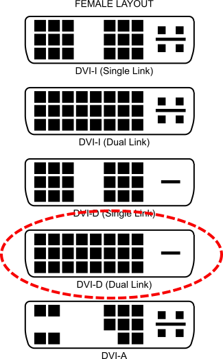

    Thanks to clem57 image inquiry I was motivated (i.e. reminded) to determine the status of video output on the Pi's. I did do it when I first asked the question but didn't document my results and make a post. Here is to answering your own question.
    I can report that all the Pi's I tried displayed video.
    Test Condition
    Monitor: ViewSonic VP171s
    Connection: DVI-D to HDMI (See drawing)
    O/S: 2019-07-10-raspbian-buster-full
    Hardware: Raspberry Pi1B, Raspberry Pi2B, Raspberry Pi Zero, Raspberry Pi ZeroW, Raspberry Pi 3B & Raspberry Pi 3B+
    In the past (i.e. sometime in the past three years) the video using an DVI/HDMI cable to this monitor and others was not working. HDMI monitor connection was the only reliable source of video. That appears to have changed. At first I would assume it was hardware but that is not the case. The Raspbian O/S development team code foo has resolved the issue to provide reliable video across all the platforms I tested. I can't tell you what O/S version the change happened but it has happened.
    Sean
