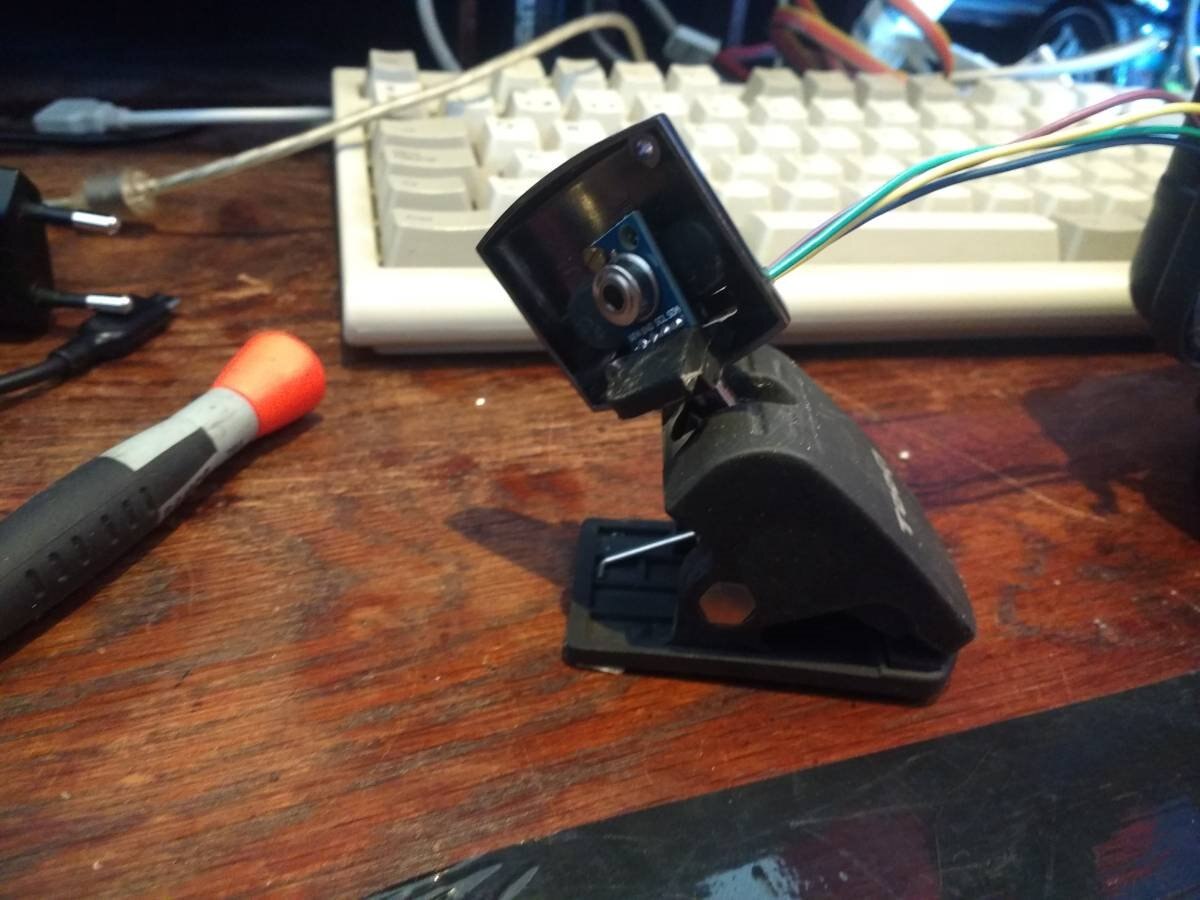

Hello,
I have a Raspberry pi 3 with a MXL90614 from Sharplace. I am using it to measure the ground temperature of a race track, but its range is something like 2cm. Is there any way to make that distance longer so I can measure it at a distance? A couple of meters would be ideal, but not sure how to do it. I've tried different lenses, but if anything they have made it worse! Could I add more power?? Or could I add a constant offset to the resultant temperature??? Thank you.
P.D: the sensor in the picture is inside a webcam support, but I angle it to get it close to the floor.
    dougw over 7 years ago
    You should be able to find an MLX90614-DCI with a 5 degree lens on it for about $60.

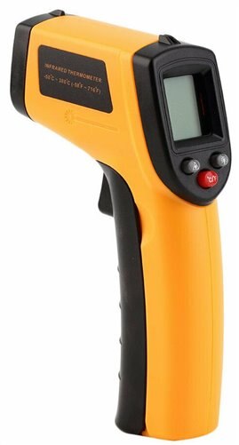

    I have a thermal sensor like this:
    When I point it at the ground today I get 20 degrees C. When I point it at the blue sky it reads -17 degrees C, so it works on whatever is in its field of view, no matter how far away it is.
    It cost about $12 but does not have a computer output - just a display.
