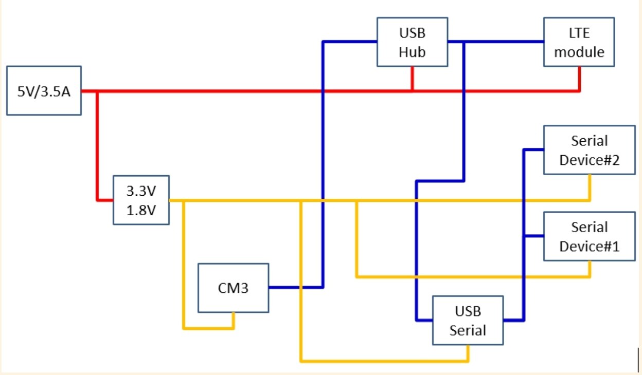

---Setup---
1) We are evaluating using Raspberry Pi Compute Module CM3.
2) USB-HUB and USB-UART are boarded on the IO board.
3) USB-HUB is working in Self-power mode.
4) VBUS-detect of USB-HUB uses the same 3.3V power supply as CM3.
5) Two LTE modules are connected to USB-HUB via USB-SERIAL and each LTE module takes 2A
---Protocol---
AT commands
---Problem----
The LTE modules which are connected to USB-HUB are disconnecting.This problem occurs only sometimes not always
