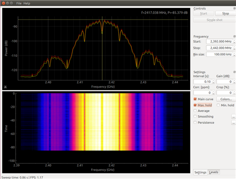

    If you do not want to use RTL-SDR as a traditional receiver demodulating to audio, then there are other dedicated applications too. For instance if you want to use it like a spectrum analyzer with no audio capabilities at all, then QSpectrumAnalyzer could be used. I used it here: Molex 2.4GHz / 5GHz Antenna Kit - Review
    Again it has its limitations, it's not something I could use everyday, it would drive me insane. But it's free, the author has made effort, and the source code is available for it too.

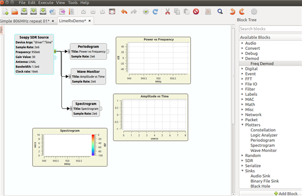

    There's also software called Pothos, which is compatible with RTL-SDR too (I've not  used it with RTL-SDR though). It works well, but is not as full-featured as the GNURadio features in the GUI, and the limitations may rule it out for you, depending on what you want to use it for.
    Pothos screenshot:
    Basically the way it works, is that you have a palette of objects, and you can connect them to create a flow. That flow defines what your SDR will do. So, you could have a source object for instance, that is the RTL-SDR source (doesn't have to be, it could be a source sinewave or any other signal - depends on the object you choose). Then you could manipulate the signal, (e.g. demodulate) and direct it to a sink object (e.g. the audio sink will send to the soundcard). Everything is sample based, so you pick a sample rate that works for your expected modulation/demodulation, and the source/sink objects seem to resample to match the connected hardware (but if there is an example sample rate someone is using and is known to work, then its best to use that). So, in the screenshot above, the sample rate is 2e6 (2MHz) which I knew was a value my SDR could handle.
    I wouldn't say it's trivially easy, especially due to the limited functionality, and limited documentation, but is still interesting to try, it may meet your needs. I use it as a simple signal generator (my SDR can transmit). So, I can set up a flow in Pothos, with the SDR as the sink object rather than a source object.
    The user documentation for nearly all these projects is quite bad unfortunately. I had to go through lots of web searches and youtube videos to even get just a basic flow working : ( Some of the stuff is just magic numbers. You can see in the screenshot above, top-left, that the Antenna parameter is set to LNAL for instance. That's just a magic thing that you cannot guess. It happens to be in the code for the driver to the SDR board I was using, so I have to use that value. RTL-SDR would use a different value there.

    Pothos has a FM demod block, and that seems like a subset of GNU Radio functionality, so that may have it too (but I've failed in getting GNU radio to run with my SDR so cannot offer much advice there : (
    If it's like Pothos, then you'll need to define a source block which will be the SDR, and you'll be able to type in a frequency into the configuration menus for that block. And then a single connection to FM Demod, and then another connection out from there to a sink block which will need to be set to your soundcard device in the menu for that block. That should be a minimal implementation, with no display or tuning buttons.
