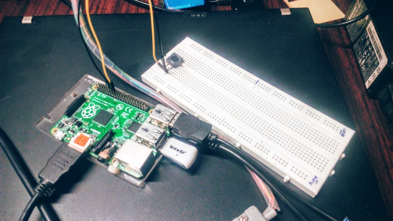

Next we need to add the button. I added a push button to the breadboard and added the connecting wires. This part will vary with the button availability. Now where do we connect it to the RPi? Well lets take a look at the diagram below.
From the diagram its clear that some of the GPIOs have dual roles as well such as UART, I2C, SPI etc. From these I chose GPIO18 because its near the GND or ground pin but you can choose one that fits your need. I suggest staying away from the dual purpose pins since you never know when you might want to add an SPI, I2C or serial peripheral in you next project. image
The image below shows my setup and you should make sure you connected the pins right.
7Pt-YEAgHs53P_ClRovFCyZTdPm5qdBG2hpdMm-d3WE=w1343-h755-no
