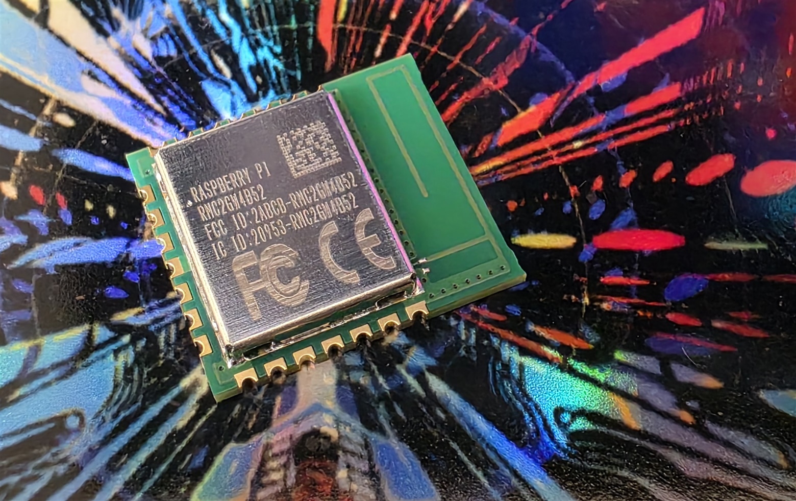

I just noticed the other day that this thing existed; it supports 2.4 GHz wireless (not 5 GHz), and Bluetooth LE (BLE); the manufacturer part code is RMC20452T , also known as RM2 and it costs about $4.
Underside; the board is 16.5 x 14.5 mm in size (but you'll need some space for a ground plane):
The RM2 is useful for custom RP2040 or RP2350 projects where WLAN (again, annoyingly just 2.4 GHz)/BLE is needed; not useful for anything else as far as I'm aware. From a software perspective, coding should be no different to using a Pi Pico W.

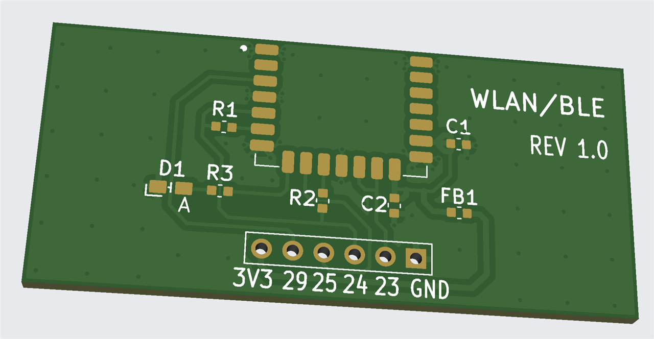

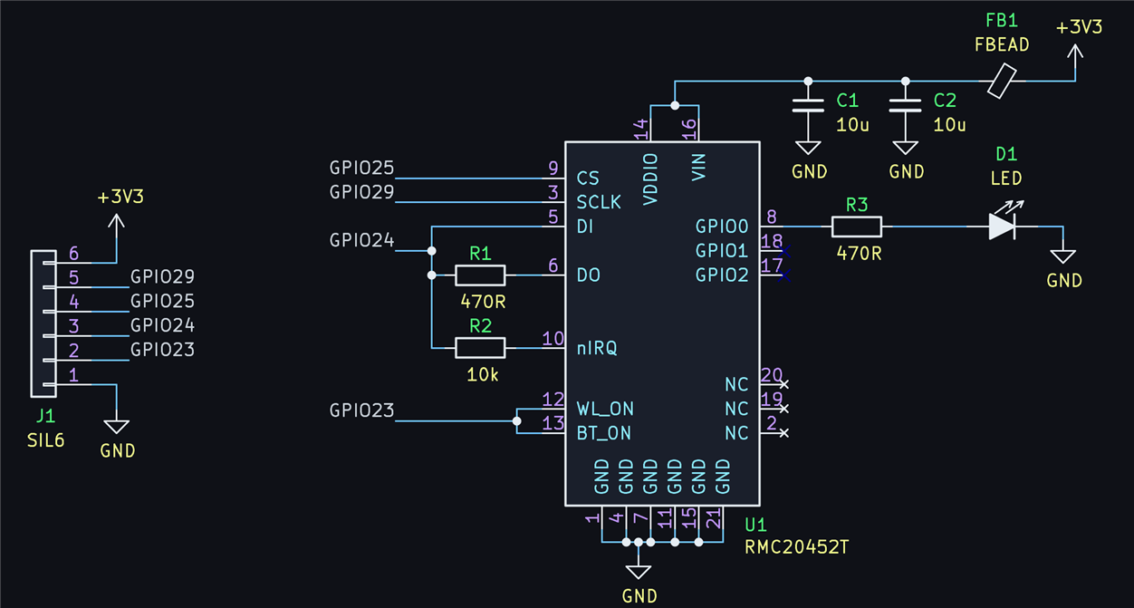

Example Circuit and PCB
Here's the circuit I used:
50 x 23mm PCB render, all passives are 0603-sized, and the LED can be 0805:
The Gerber files, and KiCad source files are downloadable here:
export_gerber_wlan_ble_rev1.zip
rm2_wlan_board.zip

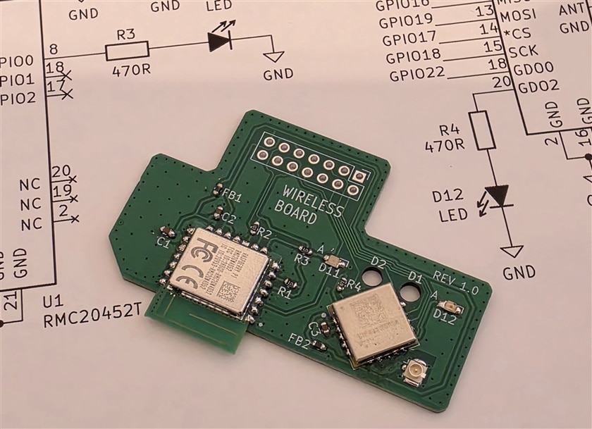

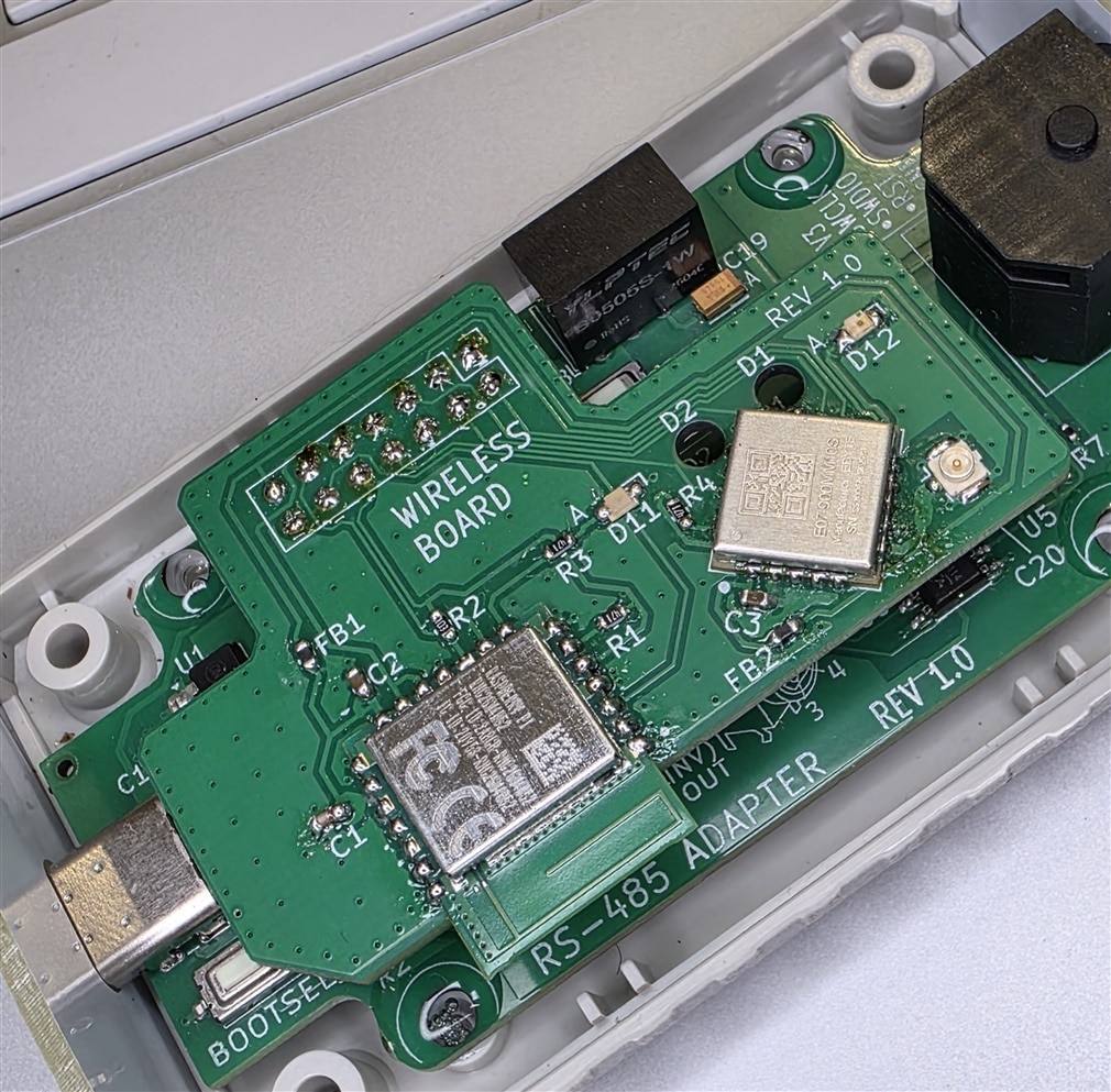

    Here's a board attempt with two wireless modules (both don't need to be populated). Circuit diagram: The unusual board shape is needed to fit over the main PCB: The Sub-1GHz module (eByte E07…
    shabaz 1 month ago
    Circuit diagram:
    The Sub-1GHz module (eByte E07-900MM10S) is not intended for LoRa, but the footprint is pin-compatible with a LoRa module (E22-900MM22S) if desired, but that uses a couple of extra pins, which I didn't wire up (they would need to be patched to GPIO pins on this current board).
    shabaz 2 months ago
    Here's an attempt (the link to the KiCad files and Gerbers has been placed in the blog). The board size is 50 x 23 mm, which costs £6.67 for ten PCBs (I will populate these by hand, the parts are large and easy to solder), including tax/shipping. A combined board with this and CC1101 would be good, I might try that at some later point, since I can see use-cases for both together.
