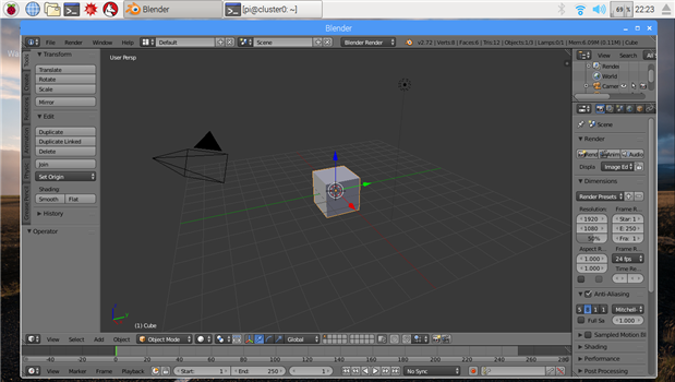

As Blender is a graphical program, it made sense to attach a screen to my controller node and launch the application. It takes a while to launch but eventually it returned the default scene of a cube and a light. Even on the Pi3, it's pretty slow to use from the graphical interface so I'd not want to have to use this for creating the scenes on the Pi. The menus are unresponsive and even just navigating the file structure is a challenge.

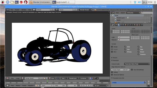

I downloaded some sample files and rendered the first one. A couple of minutes later it appeared.

blender -b /mnt/network/Samples/AtvBuggy/buggy2.1.blend -o /mnt/network/Samples/AtvBuggy/buggyrender -f 1
The parameters are:
-b scene to load in background
-o output file
-f number of frame to render
On the Pi3 that generated the file in 01:00.38.
the Pi2 takes a little longer 01:15.89.
