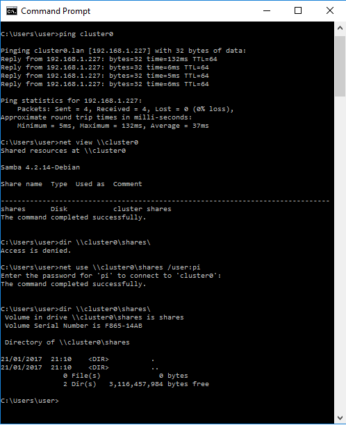

Samba Client
I checked that I could connect from my windows desktop.

I created a file in my folder and checked it could be read over the network with
ls /mnt/network

Finally I tested the configuration with a reboot and
ping 10.1.1.200
