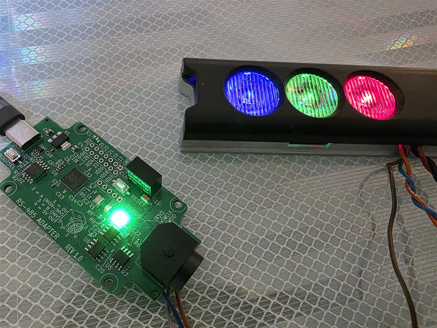

Just a few wires need to be connected, from a Pi Pico board, to a 3.3V RS-485 transceiver board.
GPIO 0 : UART TXD (output from RP2040), connected to input of RS-485 transceiver
GPIO 1 : UART RXD (input for RP2040), currently unused
GPIO 2 : Driver Enable, connected to both the DE pin and the *RE pin of the RS-485 transceiver
GPIO 12: Connect this to an LED (via a suitable resistor). The LED simply lights up to indicate if the firmware is running, but it may be used for other purposes in the future.
Here's an example RS-485 board that could be used; the key thing is to select a 3.3V version (because that's the logic level voltage that the Pi Pico uses), not 5V!
The photo shows my setup, which uses a custom board that contains the RS-485 interface built-in, but you could just use a Pi Pico and a separate RS-485 transceiver board. As an example, the three LEDs on the DMX light shown in the photo, are controlled by DMX channels (bytes) 1, 2 and 3, from the 512 bytes that are repeatedly sent.

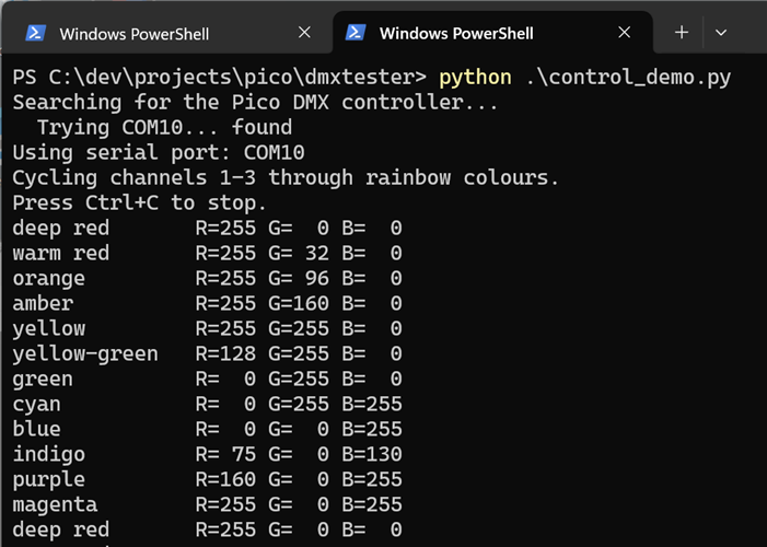

    The user menu is quite nice, the AI implemented a command history (just press the up arrow key to see previous commands) and also allows for editing within the current line using the left/right cursor keys. I might reuse this in other projects that require a menu too.
    Also, there's now a Python program called control_demo.py that will just cycle through colors using channels 1-3, it should be compatible with simple RGB DMX lamps either directly, or with a slight tweak.
    The program works by prefixing the commands with "$" and the firmware recognised that, and suppresses verbose output, so it becomes like a simple machine interface.
