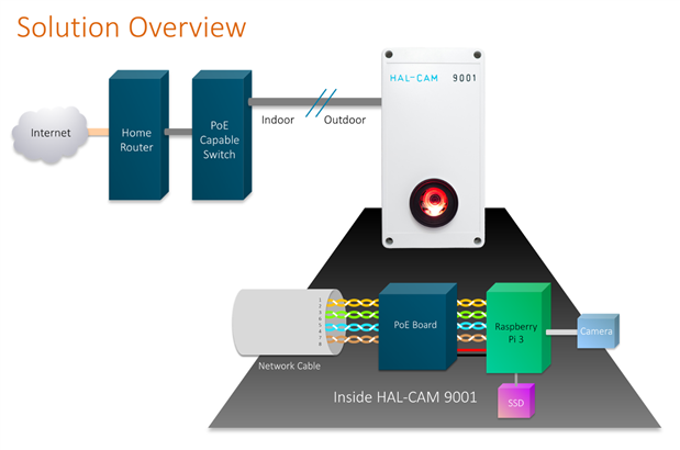

This blog post is about powering a new security camera (HAL-CAM 9001) using network cables. These could be cables already installed in an office or home environment, saving costs, or they could be new cables installed indoors or outdoors (using weather resistant cable).
This sub-project is part of the HAL-CAM 9001 project but it is generic enough to suit other scenarios too. It could be used to power a Raspberry Pi remotely for other tasks. Other single board computers (SBCs) can benefit from this project too.
HAL-CAM 9001 doesn’t have a lot of free space inside so this project was made to be ultra-compact; 2cm high and 6x5cm footprint. This project supplies 5V at up to 2.5A.

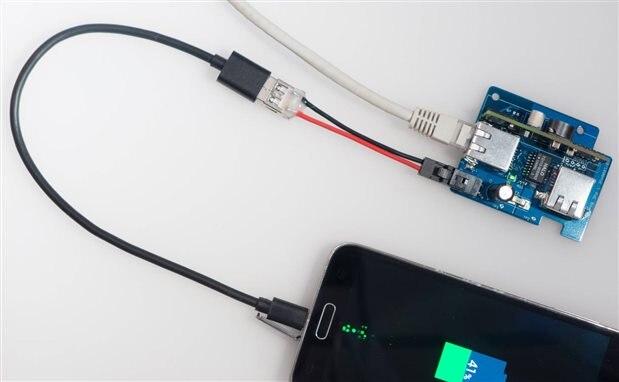

Note that the powered device doesn’t actually need to have an Ethernet connection at all. It is possible to use PoE to charge your mobile phone.

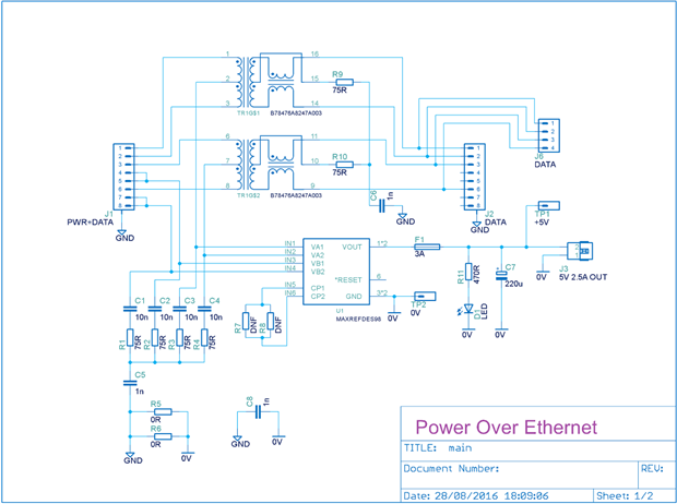

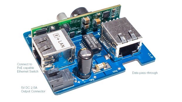

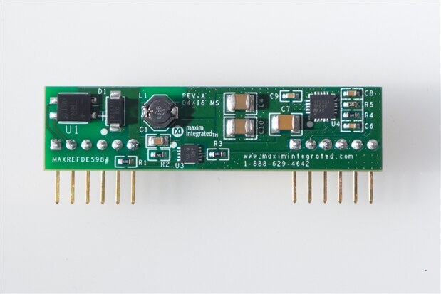

The schematic is shown below; it is really simple because most of the functionality is contained in Maxim’s MAXREFDES98MAXREFDES98 board which contains a DC-DC converter and the circuitry to handle the standards negotiation. The rest of the board mainly consists of the Ethernet transformers and connectors. Note that it would be wise to add some suppression circuitry as detailed in the original HAL-CAM blog page; I forgot to add it to this revision 1 PCB but the same method (TVS diodes) can be used as in the original blog post. At some stage I will update this blog post with revision 2 files which will correct this omission.
To construct this project, solder up the smallest parts first (the resistors and capacitors), ending with the largest parts. The fuse is optionally available in a socket which will fit the board but I chose to save some cost and directly solder the fuse.

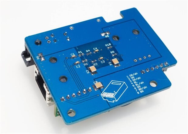

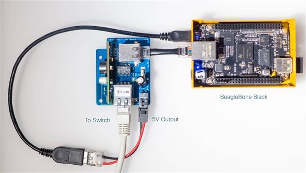

Network cables are available in short lengths but I wanted an extremely short length (a few cm) for fitting inside HAL-CAM 9001 so I used an RJ45 tool to do that. The back of the PCB has a reference indicating which color wire goes where.
Testing It
There is not much chance of error during assembly since there are so few parts in this project (the part values are in the schematic but a list of components will be published in the next few days). I connected this project via the longest length of network cable that I had (5m long) to a switch, enabled PoE on it (some switches require configuration for this) and then used a multimeter to confirm 5V was present on the output supply connector. The on-board LED was lit too, confirming that the board was receiving power. The multimeter confirmed the correct output so I proceeded to plug it into the Pi and verified that the Ethernet link came up and I had network connectivity. I can now issue a shutdown command to the Pi remotely using SSH, and then configure the switch to disable power. Whenever I want to turn the Pi on, I can configure the switch to turn on the PoE capability.

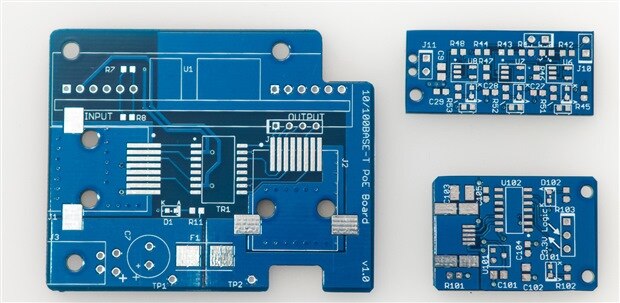

PoE is easy to use and it can be useful to be able to retro-fit non-PoE devices with the capability. The Maxim module makes this really easy. The PCB files are attached ready to send to a manufacturer. Note that the PCB also has some additional “features” (see photo below) which can be hack-sawed off and put aside for now (they are for unrelated mini-projects which will be documented at some later stage; feel free to guess what they are! It is not too difficult).

    Hi Maykol,
    You can directly use this circuit with the Arduino, however there is a complication that the Arduino usually needs 7V or slightly more, and this circuit produces 5V.
    The easiest way is to feed the power via the USB connector, which is 5V. However if you do this, then make sure that you do not connect the USB to the PC at the same time.
    An alternative approach could be to modify the circuit so that it supplies (say) 7.5V instead of 5V. This is possible by desoldering and replacing two resistors that set the regulated output voltage. The formula for this is in the MAX17503 datasheet, and they refer to resistors R3 and R4, which correspond to resistors R4 and R5 respectively in the MAXREFDES98 module (green board in the photos above). This would be a better approach if you wish to directly plug into the DC socket on the Arduino or the 7-9V supply pin. Check with a multimeter (if you don't have an oscilloscope) to ensure the output is about 7.5V before plugging in the Arduino. Also you might want to change R11 on the circuit from 470 ohms to (say) 1k ohm on the blue board, to reduce the LED brightness.
