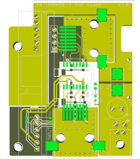

Building the Power Supply Board
The Pi will be performing a lot of computation. The Power Supply Board contains a DC-DC converterDC-DC converter which is responsible for ensuring that the Pi has a stable 5V DC supply at all times regardless of the workload. Ultimately the 5V supply will also be used to power the solid state drive (SSD), the camera and any other device attached to the Pi, so we wanted the Power Supply Board to offer around 15W of power (up to 3A at 5V). The input to the DC-DC converter is taken from the 8-wire network cable which will connect from the home to the camera location. This way just a single cable is needed to connect between home and camera, saving costs and simplifying the deployment.
Only four wires inside the cable are actually used by the Pi which means that four are available to supply DC power at a voltage suitable for the DC-DC converter input which is any value between 6-14V. We used two wires for the positive and two wires for the negative.
This scheme is not an official ‘power over Ethernet’ (PoE) scheme but to correct it a later project (now complete!) will implement standardized PoE to replace this unofficial power over Ethernet scheme which we are using.
The network cable from the outside world is connected to the Power Supply Board which actually serves two purposes. Firstly it takes the unused wires to power the DC-DC converter and supply a 5V output to the Pi. Secondly it passed through the Ethernet wires on to the Pi, but also suppressessuppresses any spikes on the wires.
The current design uses some surface mount devices (SMD) but it was assembled up using stripboard and a couple of SMD adapter boards (SOIC-8SOIC-8 and SOIC-16SOIC-16) and a normal soldering iron (2mm size bit). The SMD parts used are not overly tiny to make it easy to hand-solder. If there is interest we will design an open source PCB for this project.

HAL-CAM 9001 - Building a Power over Ethernet (PoE) Supply
    shabaz over 10 years ago in reply to Workshopshed +7
    Hi Andy, Thanks! We're just waiting now on the PoE boards from the PCB manufacturer (they have shipped, should arrive any day now), and we also need to get cracking on the software (the proof-of-concept…

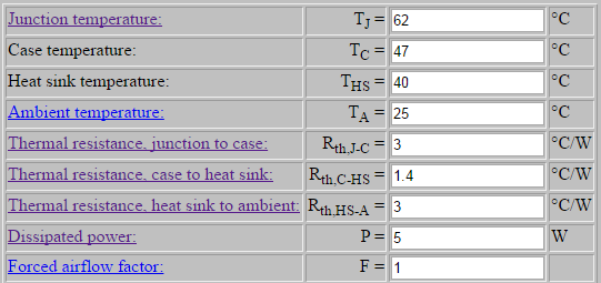

    shabaz over 10 years ago in reply to bwelsby
    Hi Brian,
    Thanks for the comments! You're right, I should try swapping out that heat sink and re-orienting it.
    I've been doing some guesstimate calculations and suspect that the main cause could actually just be the ambient temperature inside the case rising too much. It will only take a 15 degree C rise inside the case to push the SoC reported temperature into the mid-70 degrees.
    (The 1.4 value below is the combined thermal resistance of the adhesive at the SoC end, and the 0.5mm thick pad I used at the far end, and the 5W is a guess at how much of the power to be dissipated is from the SoC, since we know the Pi will be consuming about 7W total running cpuburn-a53 from previous tests).
    We know the memory chip will be getting hot, and there is DC-DC converter inefficiency too, so those are combining to warm the insides too. Basically by keeping the SoC cool and maintaining CPU speed, the problem has just been moved to the other components!
    The DC-DC converter will be dissipating more than 1W of heat, and this could be reduced slightly by dropping the input voltage from 12V, however the plan is to swap out the board with a PoE circuit (just finalizing it, board image attached below), but that will still dissipate about 1W. The RAM chip is right on the other side on the Pi's PCB, and I suspect that is contributing to temperature rise too. Although the camera mount plate has a cut-out for it, I think it would be wise to make that cut-out slightly larger, and perhaps as an experiment apply a ceramic heat sink to the memory chip and then run a fan to circulate air inside the enclosure, to get the heat away from the PCB.
    We need to get the software finalised so hopefully people can modify the h/w and the s/w to tweak the performance/thermals for their environments and to improve the design for everyone. I'm still concerned that for very hot countries we need a bigger margin still, and then even more extreme measures may be needed to keep things cool, like even water cooling (not so difficult considering that the enclosure is sealed). In any case it will be interesting to see how much performance can be got out of an outdoor Pi, even if the final software doesn't use as much resources as the cpuburn.
