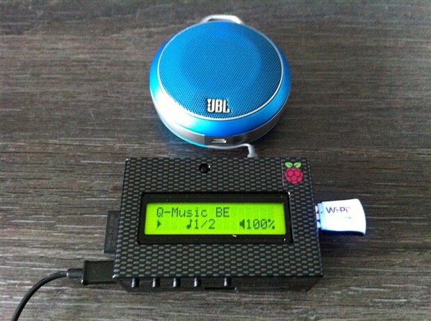

I recently worked with the PiFace Control and Display for my Santa Catcher, in which I used the PiFace CAD as an IR receiver and display without using any of the local controls.
So I decided to create an Internet Radio player which could be controlled using the PiFace CAD's buttons.
The result is mainly a software project, but I had fun diving a little deeper into the Python programming language.

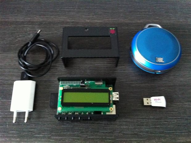

For this project, I used following components:
  • Raspberry Pi Model B running Raspbian
  • PiFace Control and Display
  • Enclosure for Pi and PiFace CAD
  • Wi-Pi
  • Portable speaker
  • 5V 1A micro USB power supply

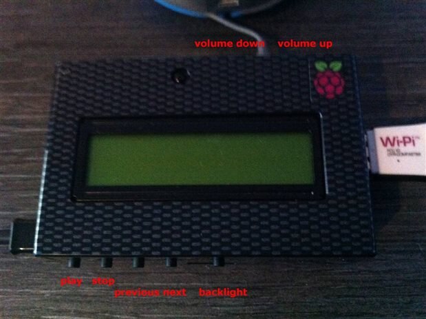

The script needs to know when a button on the PiFace CAD has been pressed and trigger the appropriate action.
I recuperated this bit of code from one of the PiFace examples and extended it to fit my application.

Above actions correspond to following button mapping:
