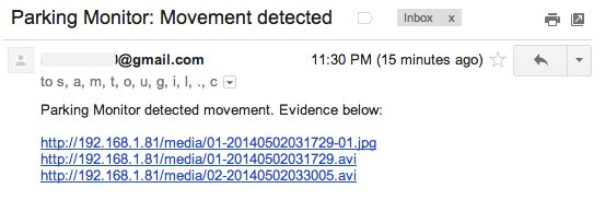

  4. Notifying based on movement

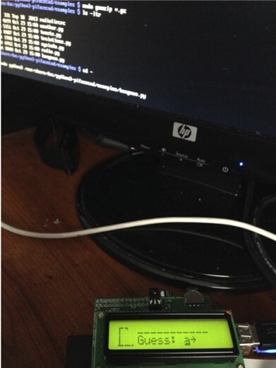

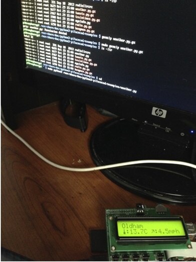

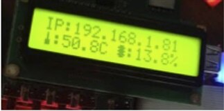

  • Test PiFace CAD Installation
    • Test that everything has been installed by running the sysinfo.py program:
    • sudo python3 /usr/share/doc/python3-pifacecad/examples/sysinfo.py
      • Note: don’t forget the sudo, otherwise you will get a permission denied
    • You will get something like the following:
  • sysinfo.py gives details about the Raspberry Pi’s IP address, temperature, and memory.
  • I also tested other Python scripts (There are several gz files under that same folder. Unzip (sudo gunzip *.gz) and test.)
  • Weather:
    • sudo python3 /usr/share/doc/python3-pifacecad/examples/weather.py
  • Even hangman image
    • sudo python3 /usr/share/doc/python3-pifacecad/examples/hangman.py

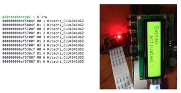

  • Set up IR remote with PiFace CAD
    • Helps us control our PiFace CAD with a TV remote
    • Before starting:
      • Set up LIRC (Linux Infrared Remote Control):
        • Software that handles interfacing between hardware & Pi media center
        • Mostly included in recent Pi distros
          • If not: apt-get install lirc
  1. Set up Infrared
  • This sets up the Raspbian Infrared module to use GPIO pin 23
    • Command: sudo modprobe lirc_rpi gpio_in_pin=23
    • No output is displayed as a result of this command but you can test it out.
  • First run “pidof lirc” to see if LIRC processes are running
    • If pidof is not installed: sudo apt-get install pidof
    • If pidof returns a number then kill that process
    • Command: sudo kill [-9] <process number>
  • Test that it works with “mode2” program:
    • Command: mode2 -d /dev/lirc0

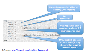

     B. Set up Your Remote
  • The /etc/lirc/lircd.conf file tells LIRC about your remote control
  • Every remote is different, so we need to download or generate a config for each remote
  • Back up original LIRC config file
    • Command: cp /etc/lirc/lircd.conf ~/.
    • Note: This will save a copy of your original lirc configuration to your home directory. If you ever want to restore these original settings use the command:
      • sudo cp ~/lircd.conf /etc/lirc/lircd.conf

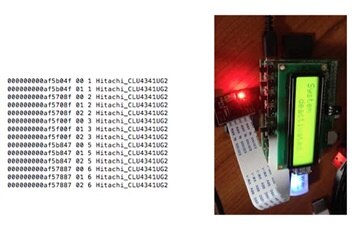

    • Copy it as lircd.conf
      • Command: sudo cp <file> /etc/lirc/lircd.conf
  • Sudo Reboot
  • Log in and issue command: irw
    • Every time you click on a button on that remote, irw would output a confirmation that it has received these key signals. Great!

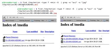

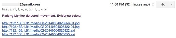

  • Detection
    • Main goal: Use the motion application which utilizes the Pi NoIR camera to detect movement. When it does, it records until that motion stops.
    • The motion application generates still images of moving objects. It can also be configured to generate videos of “live” camera stream and can be watched remotely.

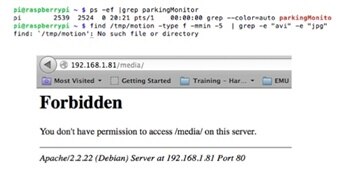

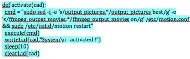

3. Activating/Deactivating Monitoring
    • Main goal: Keep monitoring the spots using the motion application and control the activation and de-activation of such monitoring
    • Activation/Deactivation
      • The configuration of motion’s web interface does not persist, which requires that we automate this task
      • Borrowed Fvan’s scripts (see later)

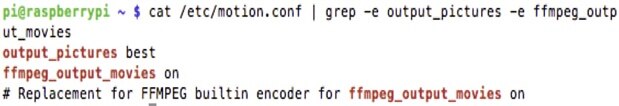

      • Two main parameters:
        • output_pictures: to generate a still image of moving object
        • ffmpeg_output_movies: to generate a movie for movement
      • Command to test initial configuration state for params:
        • cat /etc/motion.conf | grep -e output_pictures -e ffmpeg_output_movies
        • Output:
  • Command (sed) to disable both params:
    • sudo sed -i -e 's/output_pictures.*/output_pictures off/g' -e 's/ffmpeg_output_movies.*/ffmpeg_output_movies off/g' /etc/motion.conf
  • Output: None
  • Command to check params again after running script to disable params (same as above but we want to check the effect of running the above sed command):
    • Output:
    • Notice how both params are now set to off (due to the sed command)
  • Now let’s test changing from off to on (enable), with the following command:
    • sudo sed -i -e 's/output_pictures.*/output_pictures best/g' -e 's/ffmpeg_output_movies.*/ffmpeg_output_movies on/g' /etc/motion.conf
    • Output: None
  • Again, let's run the same earlier command to check params after enabling the params:
    • Output:
    • Great! So now, we have a fairly straightforward (well, at least short) command that helps us enable/disable the monitoring. Let's now turn our attention to one of the last tasks in this configuration, which is to use the PiFace CAD as a tool to visualize the status (param changes, etc.).
  • LCD Visual Indicator
    • Main Goal: Need a visual indicator once the parameters have been changed (activated/de-activated)
    • How: Display a message on the PiFace’s LCD screen
    • As suggested by fvan, it is a good idea to combine the previous (sed) commands and LCD visual indicator in one script
      • Have main snippets from script below but you're encouraged to pick it up from his post, at the reference link provided at the end of this post.
  • We need to activate the remote control with scripts
    • Refer to earlier section (Set up your Remote) for configuring remote, but remember:
  • There's a standard script that listens for specific keys. The script Name is: .lircrc
    • It reacts to signals decoded by lircd
    • Note 1: this is placed in your home directory
    • Note 2: you can optionally create a system-wide config file in /etc/lirc/lircrc which would be used when no .lircrc is found in home directory
  • Syntax for .lircrc
  • Let’s see our .lircrc script
    • Notes:
      • As it states in this figure, use python3 which we installed earlier.
      • Button config shows sequence of keys. In this case, similar to fvan's, I used 12346 for activating and 12356 for deactivating monitoring
      • As explained in the earlier Syntax figure, repeat was set to 0 so that repetitions of 1 (for example) are not interpreted as 11, 111, etc.
      • The "prog" parameter told .lircrc that irexec will respond, and therefore should be running, so let's do that.

  • Testing
    • Main goal: test that this setup is working and that I'm getting notified once a change takes place in the parking spots
    • Activating system:
  • Before detection
  • Waved hand in front of camera (for basic testing)
  • De-activating System

   b. Checking for available (recent) media
    • Look for available jpg or avi files that were modified in the last 2 minutes:
      • find /path_to_media_files -type f -mmin -2  | grep -e "avi" -e “jpg"

So, after mounting the camera, positioning it toward an area in my driveway, pressing the proper combination on the remote control (to activate monitoring), and driving in, below are snapshots from what the system captured. Note that the figures below are from several detection events; I tried to include the best ones, but you get the gist of it image.
Here's a sample e-mail notification that I received:
A sample e-mail content:
Another e-mail content:
