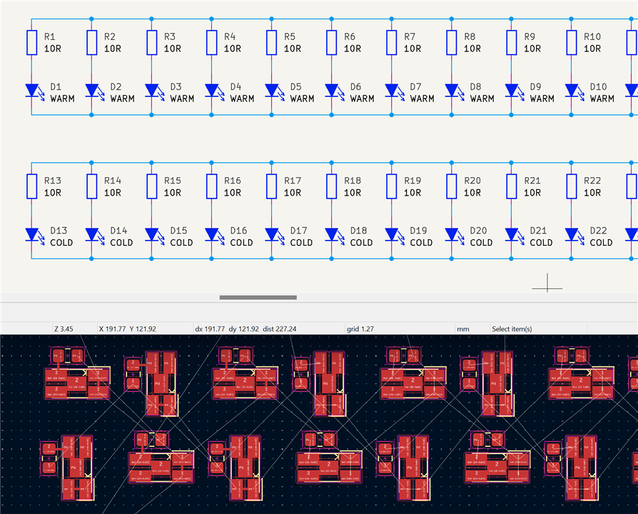

  • michaelkellett
    michaelkellett over 3 years ago in reply to shabaz +1
    This looks fine for a simple board. I've done a couple of LED lighting projects in the past. One was for a camera light which used 6 x 1W LEDs with lenses and linear current drive for three series…
    shabaz over 3 years ago in reply to michaelkellett +1
    Hi Michael, That's very interesting! I'm planning for using RJ45 connectors for DMX too, in place of the larger XLR. The ground connections seem to vary a bit between manufacturers, so I will make that…
    LED panel done.. not very ideal, but I can't really spend much time on this since I need to order some PCBs.
    The LED driver will come later, but at least I have something to connect it to!
    This is very low-cost; the LEDs (part codes mentioned in an earlier comment) will cost around £11+tax per board, and they can be tiled horizontally or vertically as needed. Each panel is 95 x 47mm.
    Not quite finished, just experimenting with how it will be mounted in larger arrays if desired. I have some ideas, just need to flesh it out. This little panel is just approx 100 x 50mm, so I'd like to be able to connect at least up to 2x2. That should be a lot of light!
    shabaz over 3 years ago in reply to shabaz
    I take it back, it is possible to route it on one layer!. Quick crude layout below. I will still do it on FR4 first though, and only move to alu if required.
    I spent some time looking into LED panels, and can't see a way to manage it in one layer, so thinking I might need to use normal FR4 instead of aluminium, and then if it really gets hot, then I'll think again! Realistically it may be about 4-5W dissipation for a panel the size of half a paperback book maybe, if the LEDs are being driven at 75% duty cycle perhaps. I was looking at these LEDs, which look very good for the low price:
    Warm LED: Wurth 158563227A
    Cold LED: Wurth 158563460
    The size seems popular, there are other LEDs in that approximate package in case they go out of stock.
    A lot of cold/warm LED modules use series strings of LEDs, and those are arranged on a single-sided aluminium PCB. But, for parallel strings (which is what I want to use, so that I can easily swap out to fewer higher power LEDs if desired), (i.e. constant current to paralleled LEDs purchased on a strip to be hopefully approximately similar, with a small resistor in series with each), I can't route it on one layer. So it will have to be FR4 I guess.
    I'm going to try to make an LED array of (say) 4x3 pairs (i.e. 12 warm, + 12 cold), and then many of them can be tiled if desired, but each of these arrays run from one pair of constant current drivers (which I still need to figure out, but they can be on a separate board sandwiched, so that the LED arrays can be easily changed as desired.
