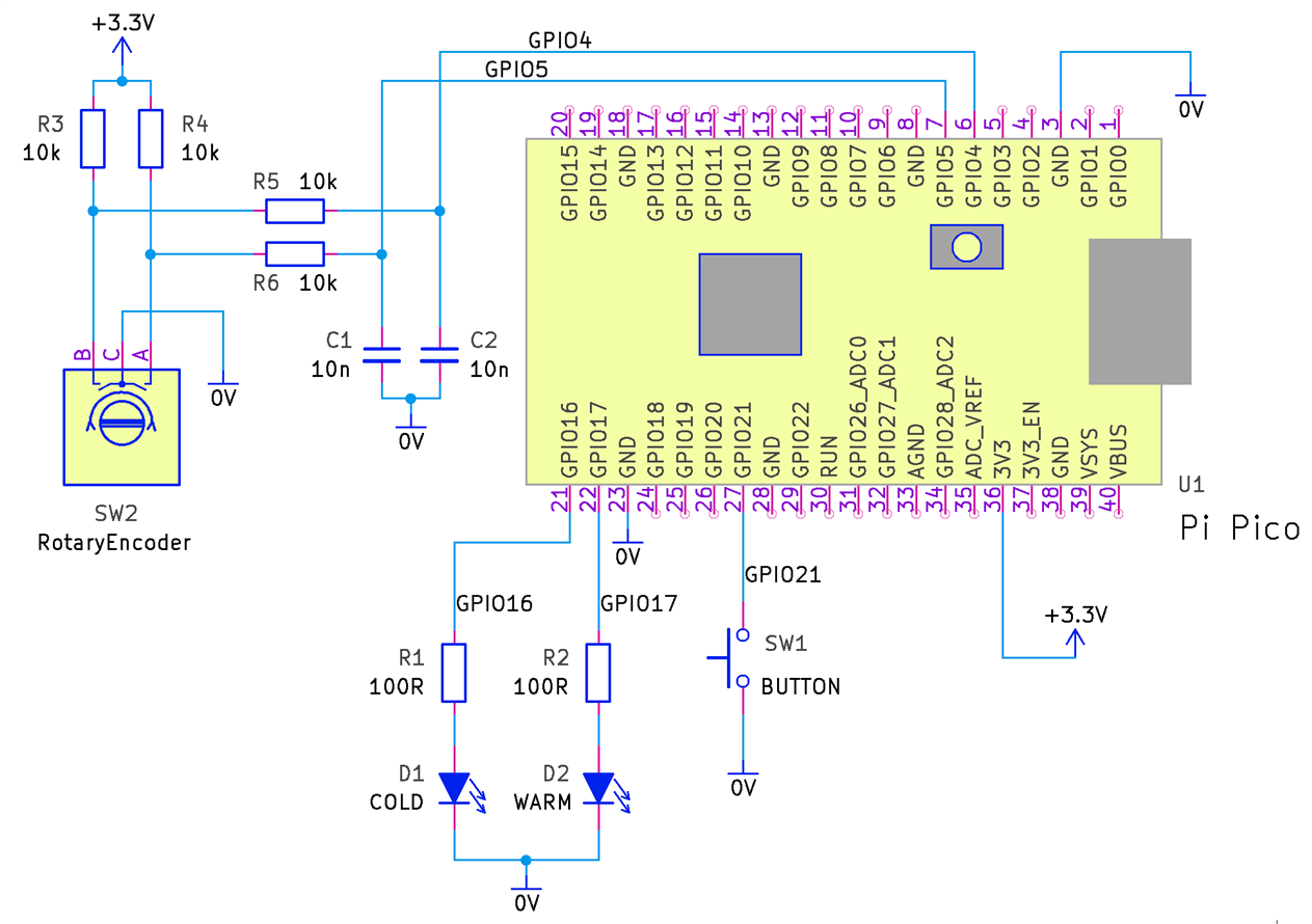

From a hardware perspective, the project is really simple; a single Pi Pico microcontroller board and a couple of low-power LEDs are sufficient to test it out. Then, it is possible to add controls to adjust the light output, and to add more powerful or better-quality sets of LEDs and drivers.
The photo above shows the prototype. There’s not much to it. A single rotary control (rotary encoder) and push-button are used to adjust the color (or more specifically the color temperature, see below for an explanation), and brightness, and there is a 7-segment LED display to show the current settings. A DIY strip of LEDs of alternating colors was connected to it via MOSFETs. Everything is managed by the Pi Pico (sitting on a Pico-Eurocard development board, but that’s not essential). The buttons and rotary control and 7-segment display are not essential either, because everything can be controlled via the optional USB port connection. In the future, I’d like to add DMX local control, and remote operation using either Bluetooth LE (BLE) or Wi-Fi (the Pico-W has in-built Wi-Fi and it would be straightforward to build on this capability).

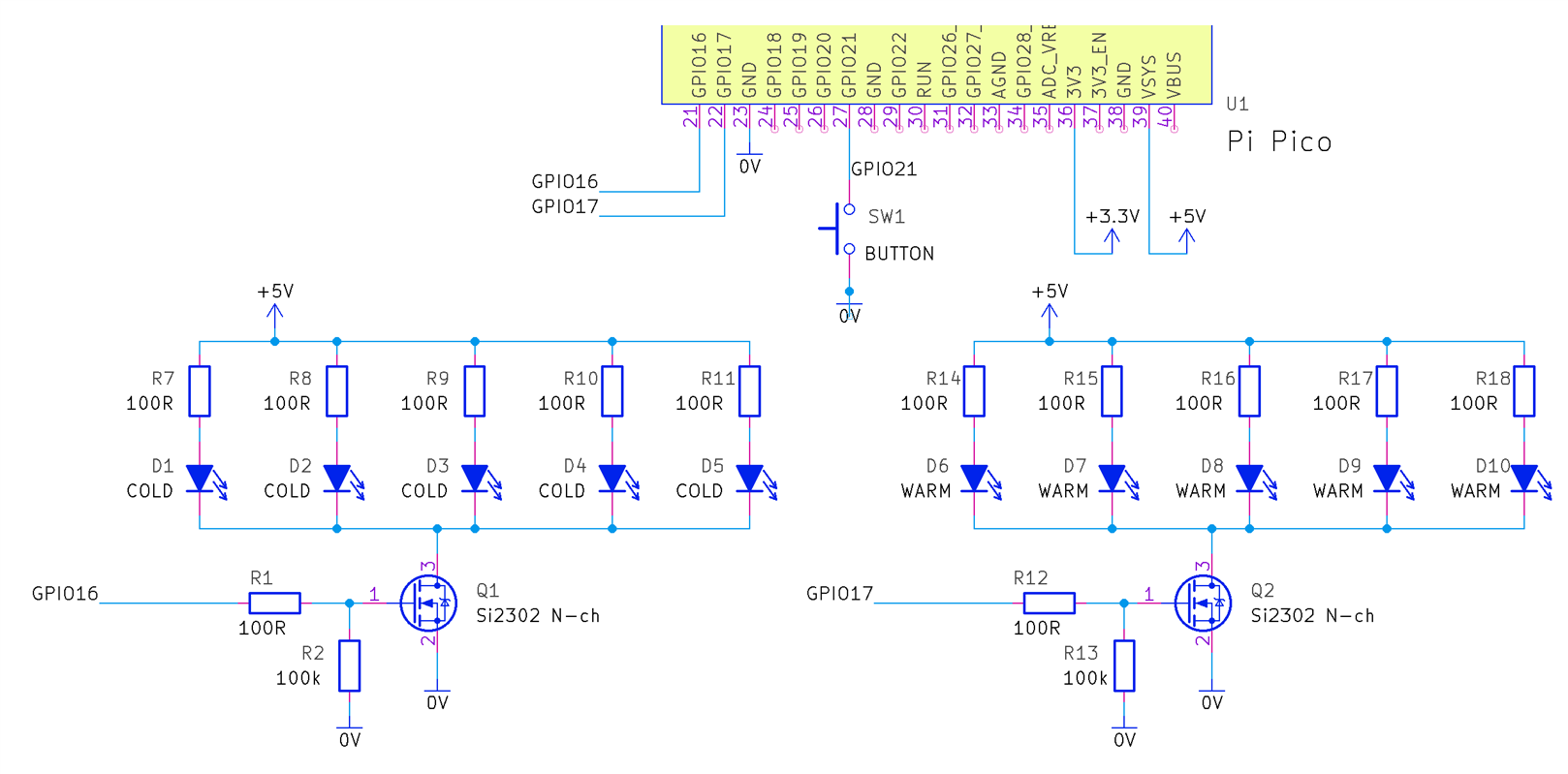

To get going quickly, this is the minimum viable circuit that is sufficient to experiment with the code; it’s not a practical light at this stage, this is just to quickly try out the code:
Any two LEDs can be used but ideally not white LEDs because they often require a voltage higher than 3.3V). You could use a couple of normal red LEDs at this stage.
Next, hold down the BOOTSEL button on the Pico, and insert the Pico USB cable into the PC. Release the BOOTSEL button. A USB memory drive letter will appear on the PC. Drag and drop the picochroma.uf2 ready-built firmware file onto the drive letter. The Pico will install the firmware into its Flash memory, and the code will begin executing.
Open a serial terminal (for instance use PuTTY) and connect to the USB serial port that will have appeared in the PC’s Device Manager (or equivalent with Mac/Linux).
Press the ‘h’ key to bring up a menu.
Now buttons can be pressed on the keyboard to experiment with the project. For instance, press the ‘c’ and ‘d’ keys repeatedly to shift the color temperature toward cold and warm colors respectively. The serial terminal will display some information as each button is pressed.
The PicoChroma source code can be edited and re-built; consult the Pico C SDK documentation to see how to do that, or alternatively check out one of the many blog posts on this topic on this site.
The circuit can be extended, and the same firmware will continue to work. The diagram below shows how to add a rotary encoder and a push button. With this circuit, the USB serial terminal menu no longer needs to be used. The push-button is used to toggle between the brightness adjustment mode and the color temperature adjustment mode.
The earlier test LEDs can be replaced with more useful cold and warm white LEDs using the following circuit modification (this still isn't a great circuit, but it is outside of the scope of this blog post for now to develop a better LED driver):

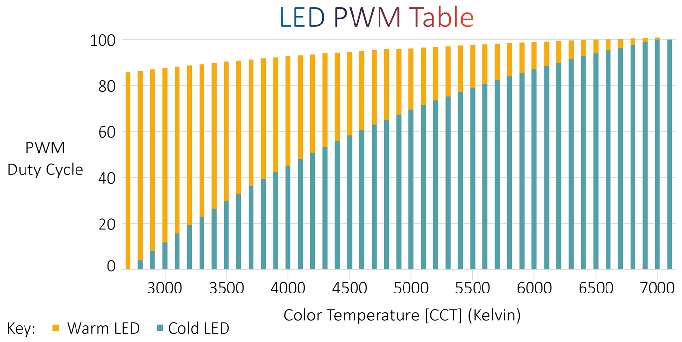

What does this all look like? The chart below (it is explained further below in this blog how such a chart can be created for any arbitrary LEDs) shows an example, using the particular LED models mentioned further above (i.e. Warm LED: Cree CLM3C-MKW-CWAXB233 and Cold LED: Cree LM1-EWN1-01-N2-00001).
The stacked column chart below shows the PWM duty cycle for those specific warm and white LEDs, in order to create white light of different color temperatures.
A few things can be observed from here, but in particular, it can be clearly seen that the warm LED never runs at 100% duty cycle, because (according to the datasheet, and as was shown in practice) the warm LED happens to be brighter.
