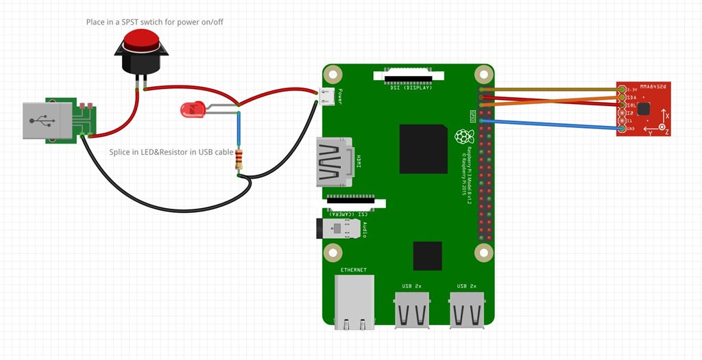

The Schematic:

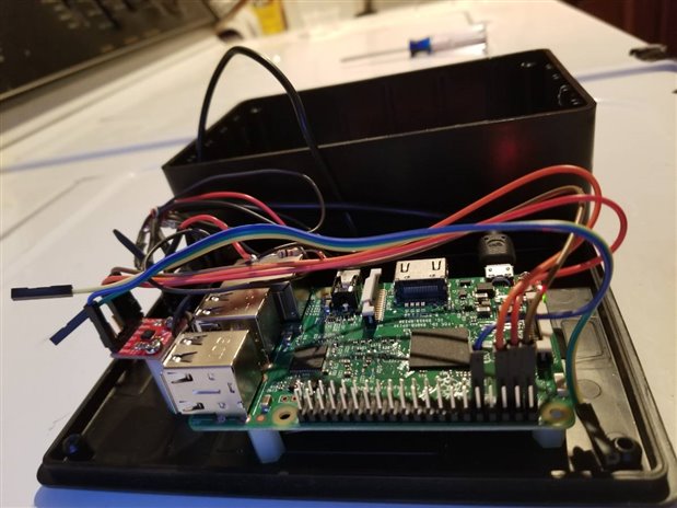

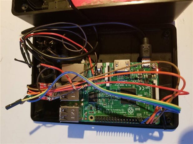

The schematic is simple. The accelerometer is attached to the Raspberry Pi 3 with four project wires.
The hardest part is OPTIONAL, adding an indicator LED and on/off switch. Technically, you can just plug in the Pi 3 to the USB battery very time you want to use it. But, if you want an easy fire-and-forget kind of device, place in that switch and LED!
The build:
How this is built doesn’t matter. At all.

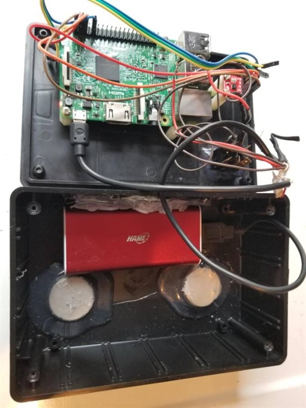

All I did was slap the components inside a project box (enclosure). It can be inside any shape box it will all fit inside. However, with my build I wanted to mitigate any issue.
- I wanted to mount the accelerometer as ridged as possible inside the box. This is to make sure that most of the movement senses is from the machine it is attached to.
- I used two large rare-earth magnets to make sure it attaches to the washer/dryer as firmly as possible. Since the whole system works off of the idea the machine will have some vibration it can sense, it’s best to make sure it doesn’t get shaken off the machine!
- Portability and temporary use needed to be considered. I didn’t want to attach the sensor system to the machines permanently. I would only use it once a week or so anyway. Then I can turn it off and store it.
For those who want to see how I put it all together, see the following gallery:
{gallery} Raspberry Pi 3 washer dryer texter

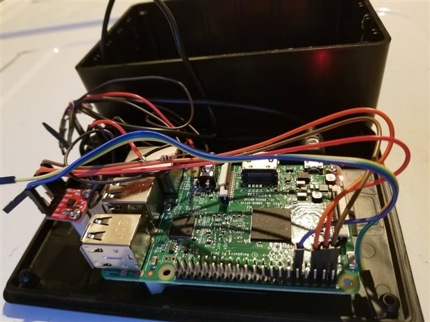

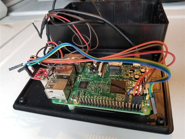

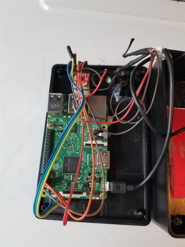

The main components are attached to the lid of the enclosure, since it is easier to attach standoffs.
The battery and he magnets are hot-glues to the bottom of the main enclosure compartment.
Although project wires are long, they do not interfere with the battery.
The micro-USB connection that powers the Pi 3 is spliced inside the box for the on/off switch and the LED/resistor.

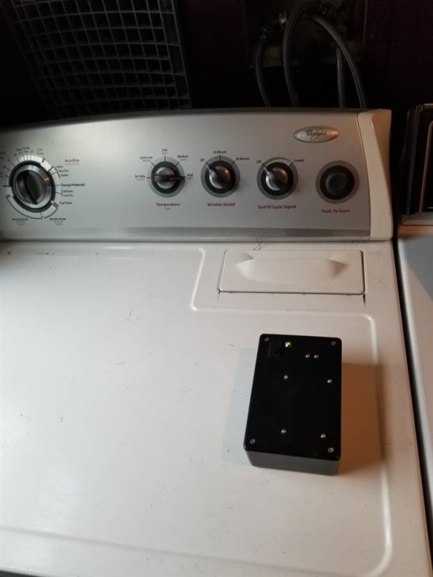

This is the complete system enclosed in the box and turned on.
Function:
We created a wireless box that attaches to your washer or dryer via magnets. There is a switch and LED on the top of the box that let you turn on and off the device and show you an indication whether the box is on or off. When the user is using their washer or dryer, they simply turn on the device before they start the washer or dryer and turn it off when they retrieve their clothes after the washer or dryer is finished with the load. The device works by detecting if the washer/dryer is on or off by reading its vibration. There are of course cycle changes in a washer and dryer that would fool the device into thinking that it is off when the motor stops for up to 30 seconds usually. A timer is implemented into the code to determine if the washer/dryer has stopped for 1 minute. Since a cycle change takes less than 1 minute, it only sends a text after 1 minute of no activity. Ensuring that the washer/dryer is done with that load. If the washer/dryer starts back up within that 1 minute then it continues to read the vibration until 1 minute of no activity to send a text. To measure whether the washer/dryer was on or off the accelerometer measures the X axis of the 3 axis provided. This is because the X axis is the horizontal plane of the surface of the dyer that moves the most.
