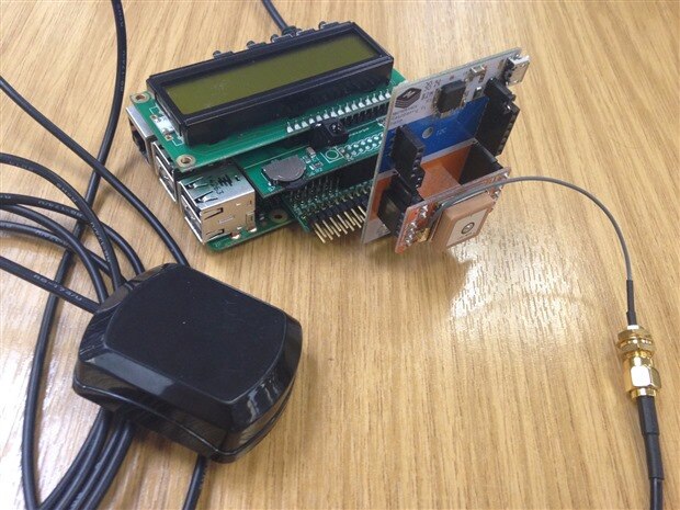

Connect it up!
When connecting together any hardware, make sure that it is turned off and not connected to a power source. This may come across as condescending but you would be surprised just at how many times I have with an absent mind dis/connected or un/plugged something in/out only to realise that I have fried the components because there was power going through the circuit.
You can go ahead and connect together all of the accessories with the Raspberry Pi 2, here is a simple step by step which might cover anything you may trip up with:
  • Un-box and unwrap the Pi 2 and its accessories, the microSD card, etc from their packaging
  • Slide the Pi 2 Shim onto the Raspberry Pi 2 GPIO (General Purpose Input/Output) pins with the pins of the shim sticking out from the Pi, making sure it has a snug fit connecting with the pins.
    • This should be such that the pins of the shim are coming up and out of the shim add-on board and bending outwards away from the Pi. Rather than down and outwards.
  • Plug the GPS add-on into the microstack board, then connect the microstack board to the Pi
    • If you read the silkscreen (white writing) on the PCB (printed circuit board) of the shim and compare it with the microstack board, you can work out the orientation to connect it up. You can also cross-reference this with the Pi 2 pinout.
    • The microstack board connects to the Pi with the microstack board orientated vertically, and towards the end of the Pi where the microSD card is to be pushed in.
  • Sit the PiFace Control & Display 2 on top of the GPIO pins, feel free to use it to push the shim further down the Pi 2 GPIO pins
  • You can connect the U.FL to SMA adaptor cable onto the the GPS add-on board and the adaptor pigtail cable to the GPS antenna.
    • The antenna is for boosting the signal strength of the GPS, you can unfurl the cable and the end should be magnetic, it works best out or next to a window. Or outside entirely
    • If you are outside, you may not need the external antenna, but it does help
  • Push in the microSD card
    • It should already be setup with NOOBS, we will need to choose an operating system
  • Connect the USB mouse and keyboard (if you are using them, else happily use SSH, if you want to know how then let me know in the comments)
  • Connect a cable to let you use a monitor or television (as outlined in the extra parts above, but feel free to ignore if you are connecting via SSH)
Lastly, after making sure that everything is securely connected, plug in the 5 volt 2 ampere power supply to the Raspberry Pi 2 (not the microstack board) and ensure everything is switched on and to the correct input/channel and you should be good to go. It should look a little like this when connected together:

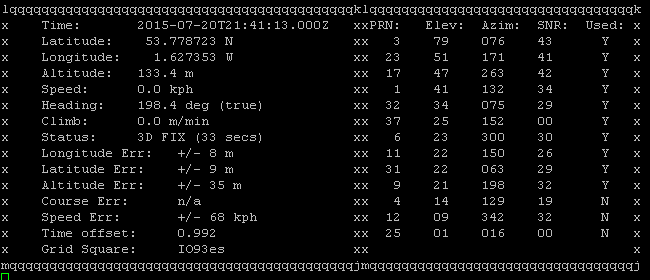

Now we should check to see if the GPS device is working, remember when you used raspi-config to disable the output on the serial port? That was important, because the microstack GPS add-on uses that to communicate its co-ordinate data which is handled in Linux as /dev/ttyAMA0. Even though the GPS add-on is in the SPI section of the microstack board, it does not even use SPI. This is a little frustrating because it stops us from using SPI add-ons in the microstack when we should really be able to use them, but the way the GPS add-on operates means that we can use it in conjunction with an SPI add-on such as the PiFace Control & Display 2.
Testing the GPS Add-on
How we check if the GPS add-on is working will depend greatly on whether you have a signal lock or not. Hopefully by now you will have had the Pi connected to power with the add-ons all plugged in. If the GPS has a lock then you should have a flashing red LED, this is synchronised with the clock of the timing signal received from the satellites. Now we can run a command to check what information we have.
If gpsd has been configured correctly, then we can run:
cgps -s
Which will produce an output that looks like this:
Though your output might have the correct characters as a border. What we have here is a '3D Fix' along with the details we would expect such as longitude and latitude. However, what can we do if it says "NO FIX" ? How do we know if the GPS add on is working at all?
The simplest way is to check if /dev/ttyAMA0 is receiving any data at all. There is a command in Linux called 'cat' which we can use to view the contents of files, I shall not go into detail of why, but we can also use cat on devices. So when we run:
cat /dev/ttyAMA0
You should see the serial output from the microstack add-on which looks like this (press CTRL and C to stop the scrolling data):
$GPGGA,225204.000,5346.7246,N,00137.6337,W,1,8,1.03,128.2,M,47.8,M,,*42
$GPGSA,A,3,17,32,02,23,09,03,31,06,,,,,1.73,1.03,1.38*05,M,47.8,M,,*42
$GPGSV,3,1,12,23,72,110,18,09,55,200,44,06,52,293,43,03,47,089,28*7B42
$GPRMC,225205.000,A,5346.7246,N,00137.6337,W,0.02,198.38,200715,,,A*71
$GPVTG,198.38,T,,M,0.02,N,0.04,K,A*30
$GPGGA,225205.000,5346.7246,N,00137.6337,W,1,8,1.03,128.2,M,47.8,M,,*43
$GPGSV,3,2,12,17,27,230,31,02,16,310,30,31,16,033,31,01,10,143,18*77
$GPGSV,3,3,12,32,07,087,16,25,05,349,17,40,05,110,,12,02,315,17*7F
$GPGLL,5346.7246,N,00137.6337,W,225205.000,A,A*4E
$GPTXT,01,01,02,ANTSTATUS=OK*3B
Your output would be different if you do not have a GPS fix. There is detailed information in this feed which we can digest if we want to, what I am interested in is where it says 'ANTSTATUS=OK' means that we have the external antenna attached and it is working (pretty neat) else it would say 'ANTSTATUS=OPEN'. The rest I can ignore for now.

    This is the connector I got and this is how I solder on the shim. And it works perfect.

    I gave up on my shim.  I think you need to solder it in very lightly, on all pins.  You cant have any solder humps though..  I was using mine on a project that may get jolted so I didn't trust it.
  • dmedlow
    dmedlow over 11 years ago in reply to cmelement14
    I'm having what seems to be the same problem - the shim isnt making sufficient contact with the pins and the GPS board (when relocated to the vertical pins) no longer works.
    I can get the GPS to work by bending the shim board so that a greater surface area is available between the pins and the holes however when I then go to place the display board on the original Pi IO pins this presses down on the shim board so it is flat against the Pi IO connector and breaks the connection to the GPS.
    I may have to get the connector you mentioned above.
    e14 Contributor over 11 years ago in reply to stvnford
    I have ordered the part that Mao posted about below but in the meantime and as a workaround that is working so far I removed the plastic pin spacers on the gpio pins of the Pi.  I broke/chipped the plastic that surround the pins in my prying but I eventually got the 2x20 plastic piece off and may be able to reuse some of it if need be in future.  But this allowed the shim to slide down all the way to the base of the gpio pins on the pi and allows the piface to accept a longer pin.  I think this helps pull the pins a bit closer and make contact.  But I was still getting some timeouts with cgps -s when I went to move the Pi around as it lost connection.
    I think I may solder the shim directly to the pi for the final product and then use one of the new headers that come in to relocate the microstack/gps to make casing it easier.
