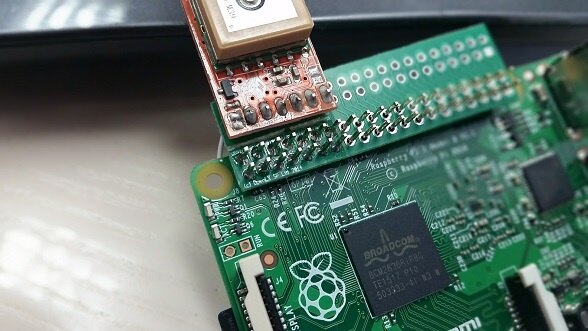

Connect it up!
When connecting together any hardware, make sure that it is turned off and not connected to a power source. This may come across as condescending but you would be surprised just at how many times I have with an absent mind dis/connected or un/plugged something in/out only to realise that I have fried the components because there was power going through the circuit.
You can go ahead and connect together all of the accessories with the Raspberry Pi 2, here is a simple step by step which might cover anything you may trip up with:
  • Un-box and unwrap the Pi 2 and its accessories, the microSD card, etc from their packaging
  • Slide the Pi 2 Shim onto the Raspberry Pi 2 GPIO (General Purpose Input/Output) pins with the pins of the shim sticking out from the Pi, making sure it has a snug fit connecting with the pins.
    • This should be such that the pins of the shim are coming up and out of the shim add-on board and bending outwards away from the Pi. Rather than down and outwards.
  • Plug the GPS add-on into the microstack board, then connect the microstack board to the Pi
    • If you read the silkscreen (white writing) on the PCB (printed circuit board) of the shim and compare it with the microstack board, you can work out the orientation to connect it up. You can also cross-reference this with the Pi 2 pinout.
    • The microstack board connects to the Pi with the microstack board orientated vertically, and towards the end of the Pi where the microSD card is to be pushed in.
  • Sit the PiFace Control & Display 2 on top of the GPIO pins, feel free to use it to push the shim further down the Pi 2 GPIO pins
  • You can connect the U.FL to SMA adaptor cable onto the the GPS add-on board and the adaptor pigtail cable to the GPS antenna.
    • The antenna is for boosting the signal strength of the GPS, you can unfurl the cable and the end should be magnetic, it works best out or next to a window. Or outside entirely
    • If you are outside, you may not need the external antenna, but it does help

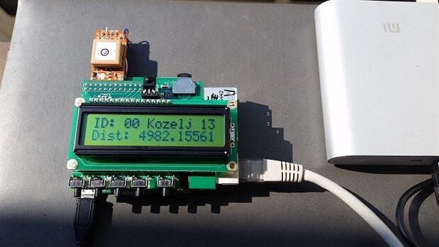

Can we go Geocaching Yet?
To start this project we are going to use code from 's work (he has some other neat blogs you should really check out that introduces other hardware we have on the Community). The full blog post is available here if you would like to read it, it gives good insight into the decisions for the code we are about to use and what I intend on developing upon further. For now though, all we are going to do is download the file attached to this blog post, extract them and run the code.
On the Raspberry Pi, in the desktop environment open a web browser and download the .zip file. Using 'File Manager' in the 'Accessories' menu, copy the file from the downloads folder into the the /home/pi folder (by default it may download to /home/pi/downloads).
Now open up a terminal (unless you are already in one) and run the following commands:
cd ~/
unzip gps-files.zip
sudo cp ./start.sh /etc/init.d/
sudo chmod +x /etc/init.d/start.sh
sudo update-rc.d start.sh defaults 99
Callum's Geocaching software looks at a text file for a list of co-ordinates as longitude and latitude. You will need to edit this file with a text editor and input your own co-ordinates to the geocaches you want to find or locations you want to be pointed towards. Now to edit geocaches.txt, either use your terminal text editor of choice (I prefer to use vim), or open 'Text Editor' from the 'Accessories' menu and navigate to /home/pi/microstack_geocache
Just to test the co-ordinates, which are listed in longitude and latitude, I picked some locations at random on Google Maps and saved them into geocaches.txt:
-1.552677,53.779964
-1.384277,53.32103
-0.049438,52.629729
That should be everything, when you restart your Raspberry Pi the code should automatically run and you will be told the distance towards the caches listed in geocaches.txt in /home/pi/microstack_geocache ! You can use the 'flick' or 'nav' switch to choose between the different caches in your text list.

    This is the connector I got and this is how I solder on the shim. And it works perfect.

    e14 Contributor over 11 years ago +1
    Thats the way how I manage this problem...its working now 1. cutting+soldering 2. working

    There are a few options, one is to resolder the PiFace with a stackable header instead of what it currently has, that way you can put devices on top of it. Or solder wires to the appropriate pins or similar.
    One side of the Pi Shim has the pin sockets slightly off-set to one another to try to 'grip' onto the pins, I think the other side does not and expects you to solder pins onto it image
    Thats the way how I manage this problem...its working now image

  • cmelement14
    cmelement14 over 11 years ago in reply to cmelement14
    After soldering the male-to-male connector to the shim board, problem isn't solved. The problem must be the contact between GPIO and shim. I am not going to solder on the GPIO pins on Pi. Instead, I will look for an appropriate a connector for the job.
  • cmelement14
    I have the same problem with the shim. I am going to solder the male-to-male connector to the shim board and give a try (obviously soldering the shim to the GPIO pins on Pi is not a good idea).
  • stvnford
    stvnford over 11 years ago in reply to stvnford
    I did find that the pins will slide within the black plastic spacer.  sliding the pins about 1mm closer seems to have tightened things up a bit but any device (either the Piface or GPS) connected via the pins / shim still don't "connect".
    Now that I see soldering isn't a good solution I'll have to find another work-around....maybe give the breadboard a try to see if I can at least get the two parts connected.
    One would think that a part provided for this purpose wouldn't require additional tinkering to make it work....but such is the life of a builder image
    I watched your YouTube video and came up with the same results....something is surely wrong with the shim.
