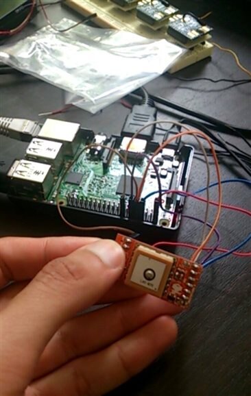

Connect it up!
When connecting together any hardware, make sure that it is turned off and not connected to a power source. This may come across as condescending but you would be surprised just at how many times I have with an absent mind dis/connected or un/plugged something in/out only to realise that I have fried the components because there was power going through the circuit.
You can go ahead and connect together all of the accessories with the Raspberry Pi 2, here is a simple step by step which might cover anything you may trip up with:
  • Un-box and unwrap the Pi 2 and its accessories, the microSD card, etc from their packaging
  • Slide the Pi 2 Shim onto the Raspberry Pi 2 GPIO (General Purpose Input/Output) pins with the pins of the shim sticking out from the Pi, making sure it has a snug fit connecting with the pins.
    • This should be such that the pins of the shim are coming up and out of the shim add-on board and bending outwards away from the Pi. Rather than down and outwards.
  • Plug the GPS add-on into the microstack board, then connect the microstack board to the Pi
    • If you read the silkscreen (white writing) on the PCB (printed circuit board) of the shim and compare it with the microstack board, you can work out the orientation to connect it up. You can also cross-reference this with the Pi 2 pinout.
    • The microstack board connects to the Pi with the microstack board orientated vertically, and towards the end of the Pi where the microSD card is to be pushed in.
  • Sit the PiFace Control & Display 2 on top of the GPIO pins, feel free to use it to push the shim further down the Pi 2 GPIO pins
  • You can connect the U.FL to SMA adaptor cable onto the the GPS add-on board and the adaptor pigtail cable to the GPS antenna.
    • The antenna is for boosting the signal strength of the GPS, you can unfurl the cable and the end should be magnetic, it works best out or next to a window. Or outside entirely
    • If you are outside, you may not need the external antenna, but it does help
  • Push in the microSD card
    • It should already be setup with NOOBS, we will need to choose an operating system
  • Connect the USB mouse and keyboard (if you are using them, else happily use SSH, if you want to know how then let me know in the comments)
  • Connect a cable to let you use a monitor or television (as outlined in the extra parts above, but feel free to ignore if you are connecting via SSH)
Lastly, after making sure that everything is securely connected, plug in the 5 volt 2 ampere power supply to the Raspberry Pi 2 (not the microstack board) and ensure everything is switched on and to the correct input/channel and you should be good to go. It should look a little like this when connected together:

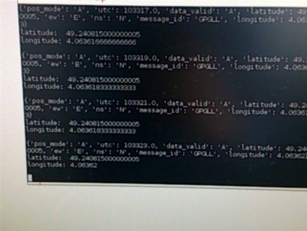

Now we should check to see if the GPS device is working, remember when you used raspi-config to disable the output on the serial port? That was important, because the microstack GPS add-on uses that to communicate its co-ordinate data which is handled in Linux as /dev/ttyAMA0. Even though the GPS add-on is in the SPI section of the microstack board, it does not even use SPI. This is a little frustrating because it stops us from using SPI add-ons in the microstack when we should really be able to use them, but the way the GPS add-on operates means that we can use it in conjunction with an SPI add-on such as the PiFace Control & Display 2.
Testing the GPS Add-on
How we check if the GPS add-on is working will depend greatly on whether you have a signal lock or not. Hopefully by now you will have had the Pi connected to power with the add-ons all plugged in. If the GPS has a lock then you should have a flashing red LED, this is synchronised with the clock of the timing signal received from the satellites. Now we can run a command to check what information we have.
If gpsd has been configured correctly, then we can run:
cgps -s
Which will produce an output that looks like this:
Though your output might have the correct characters as a border. What we have here is a '3D Fix' along with the details we would expect such as longitude and latitude. However, what can we do if it says "NO FIX" ? How do we know if the GPS add on is working at all?
The simplest way is to check if /dev/ttyAMA0 is receiving any data at all. There is a command in Linux called 'cat' which we can use to view the contents of files, I shall not go into detail of why, but we can also use cat on devices. So when we run:
cat /dev/ttyAMA0
You should see the serial output from the microstack add-on which looks like this (press CTRL and C to stop the scrolling data):
$GPGGA,225204.000,5346.7246,N,00137.6337,W,1,8,1.03,128.2,M,47.8,M,,*42
$GPGSA,A,3,17,32,02,23,09,03,31,06,,,,,1.73,1.03,1.38*05,M,47.8,M,,*42
$GPGSV,3,1,12,23,72,110,18,09,55,200,44,06,52,293,43,03,47,089,28*7B42
$GPRMC,225205.000,A,5346.7246,N,00137.6337,W,0.02,198.38,200715,,,A*71
$GPVTG,198.38,T,,M,0.02,N,0.04,K,A*30
$GPGGA,225205.000,5346.7246,N,00137.6337,W,1,8,1.03,128.2,M,47.8,M,,*43
$GPGSV,3,2,12,17,27,230,31,02,16,310,30,31,16,033,31,01,10,143,18*77
$GPGSV,3,3,12,32,07,087,16,25,05,349,17,40,05,110,,12,02,315,17*7F
$GPGLL,5346.7246,N,00137.6337,W,225205.000,A,A*4E
$GPTXT,01,01,02,ANTSTATUS=OK*3B
Your output would be different if you do not have a GPS fix. There is detailed information in this feed which we can digest if we want to, what I am interested in is where it says 'ANTSTATUS=OK' means that we have the external antenna attached and it is working (pretty neat) else it would say 'ANTSTATUS=OPEN'. The rest I can ignore for now.

    This is the connector I got and this is how I solder on the shim. And it works perfect.

    Thats the way how I manage this problem...its working now 1. cutting+soldering 2. working

    My connection is as follows:
    Microstack GPS RX -> TX pin number 8 for raspberry PI 2
    Microstack GPS TX -> RX pin number 10 for raspberry PI 2
    GND -> 6 pin number for raspberry PI 2
    VCC 3.3V -> pin number 1 for raspberry PI 2
    0 Microstack GPS -> GPIO4 pin number 16 for raspberry PI 2
    1 Microstack GPS -> PCM_CLK / PWM0 pin number 12 for raspberry PI2
    e14 Contributor over 11 years ago in reply to cstanton
    i use python for element14 gpscat.py
  • cstanton
    cstanton over 11 years ago in reply to e14 Contributor
    What're you using to get that output?
    Yes this is what I get :
