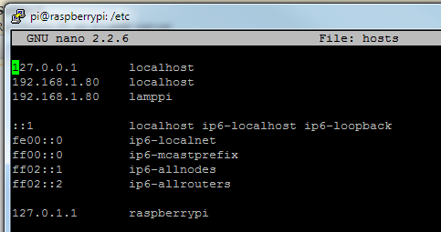

If you restart Apache (using the command sudo service apache2 restart) you will see an error along the lines of Could not determine the server's fully qualified domain name, using 127.0.X.1 for ServerName.
This is because the Pi hasn't been set up as a named server. This can be done quite easily - all you need to do is decided on a name for your server, and to know your IP address.
For the following instructions I have chosen to call my pi lamppi - and my IP address is 192.168.1.80
N.B. To edit files use sudo nano filename - e.g. to edit file hostname in directory /etc;
cd /etc sudo nano hostname
Edit file hostname in directory /etc to contain the entry as below (using the name you have chosen for your server).
Edit file /etc/hosts as below. you need to
  • Add a localhost entry for your IP address (e.g. 192.168.1.80 localhost)
  • Add an entry for your chosen server (e.g. 192.168.1.80    lamppi)

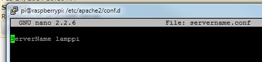

Next, create an extra file servername.comf in the /etc/apache2/conf.d. You can use nano to create the file - i.e
  • cd /etc/apache2/confd
  • sudo nano servername.conf
Create an entry as shown below
You should now find that you can stop/restart apache without any errors being thrown.
