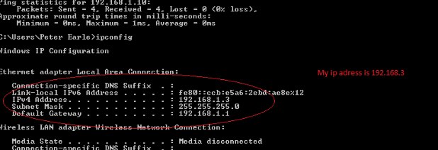

The first thing you need to do is to find out what range of addresses is available to you. If you do an ipconfig command on your PC you find out what its IP address is, and that will give you an idea of the range of IP addresses being used assigned by your router.
As you can see below the IP address for my PC is 192.168.1.3 - so my router is assigning addresses in the range 192.168.1.nnn
There are a couple of other bits on information which we will need in a minute - the subnet mask and the gateway - circled below in red.
I picked an IP address to assign ion the range that the router is using, but high enough so that it wouldn't assign it to a device I was already using. That isn't the most scientific way of doing it, but it seemed to work for me! I decide to use 192.168.1.10 for my Pi.

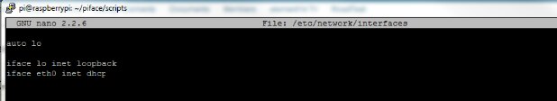

Logging on to the PI, all I e to do was to edit file /etc/network/interfaces as follows;
At a command prompt on the pi enter sudo nano /etc/network/interfaces
In the file you will see the line iface eth0 inet dhcp as shown below
Edit the line iface eth0 inet replacing dhcp with static

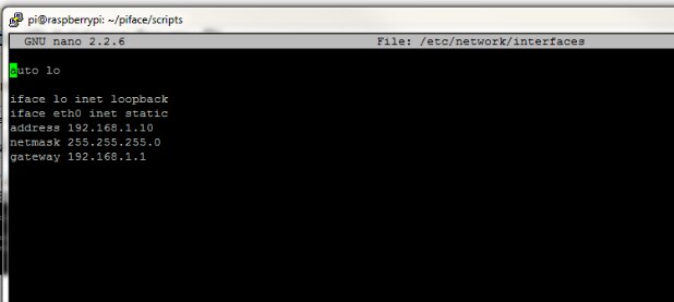

Then add the following lines
address the ip address you are going to use
netmask the subnet mask shown in tthe PC ipconfig screen
gateway the default value shown in the PC IP config scree
e.g.
address 192.168.1.10
netmask 255.255.255.0
gateway 192.168.1.1
The file should look like this

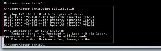

Thats it! - save the file and reboot your Pi. You should now be able to access it using the IP address you have decided - as a test, ping it from your PC, and you should see something like this;

    Mikrotik user here too - love having the flexibility to lots of interesting and useful networking configurations that consumer gear doesn't allow. Setting up static DHCP leases (or bindings) is nice to have as it requires no reconfiguration on the Pi to move it around and it persists based on MAC address.
    There are some instances where setting static IPs has its merits, especially when no DHCP server exists on the network or doesn't have the capability to memorise static leases. There are also some devices which have rather buggy clients which may not always accept the static lease doled out, especially on misconfigured networks with multiple DHCP servers. It also increases the possibility of the Pi on DHCP to be offered the wrong address by a malicious actor on the network, as DHCP is basically broadcast with no encryption, with often the first valid lease being chosen by the "victim" device. For critical intranet-only small networks, having static IPs can make sense.
    The method of using /etc/network/interfaces has been superseded by the use of dhcpd.conf on later versions of Debian based operating systems. See this thread from Raspberry Pi Foundation Forums about using the dhcpcd.conf to do this, although if you do delete the lines from /etc/network/interfaces and write in the old lines, this still seems to work for the time being but is generally not recommended.
