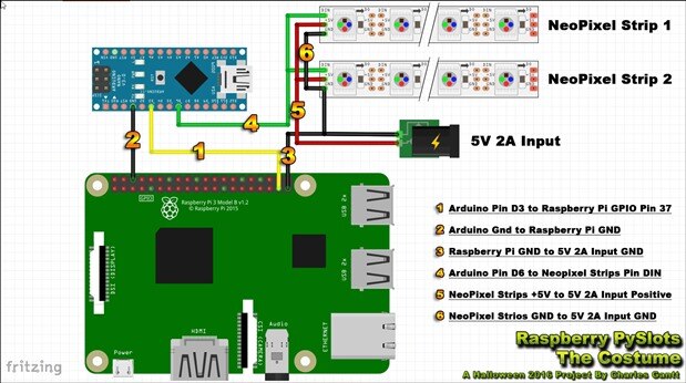

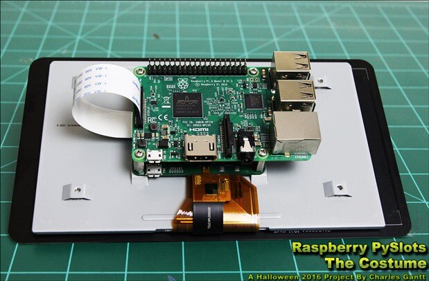

The Raspberry Pi Hardware
As I mentioned in the first post, I will be using a Raspberry Pi 3Raspberry Pi 3, and the Raspberry Pi 7-inch touchscreenRaspberry Pi 7-inch touchscreen. So before I can get started with developing the program and lighting effects, I need to get the Raspberry Pi 3, and the touchscreen mated together. I won't walk you through the process on how to set this up though as there are many of these tutorials here on Element14 already such as this one from my friend Enrico Miglino (balearicdynamics), plus it’s as simple as connecting the ribbon cable, and then screwing the Raspberry Pi to the touchscreen’s controller board when you are using a Pi 3 and the latest version of Raspbian.
With the Pi and the Touchscreen now assembled, I just needed to get the latest version of Raspbian burnt onto a SD card, and then the screen would automatically work when I boot the Pi up for the first time. I took this as an opportunity to create a video for my YouTube channel on how to burn Raspbian to an SD card. I have wanted to do a series on Raspberry Pi Basics for a while now, and this project gave me the push I needed to get started on that. Check out the video below, and let me know what you think!

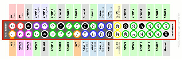

Line 29: Imported the RPi.GPIO library
import RPi.GPIO as GPIO ## Import GPIO library\
Line 35: Set the GPIO Mode to BOARD
GPIO.setmode(GPIO.BOARD) ## Use board pin numbering
Line 36: Set GPIO Pin 37 as an output
GPIO.setup(37, GPIO.OUT) ## Setup GPIO Pin 37 to OUT

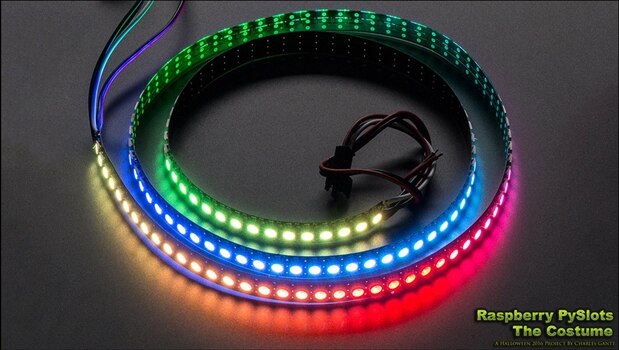

I have always been a self-proclaimed LED junkie. From as early as I can remember in my maker adventures, I have been fascinated with LEDs, and when the first NeoPixelNeoPixel / WS2811 and WS2812 strips hit the market, my life all but changed. No longer did I have to design complex circuitry and coding to manipulate RGB LED’s, I could use a single data line, and two power lines to control as many of these LEDs as I desired. For this project I knew I had to incorporate NeoPixels into the design somewhere, and my solution was to use them for both advertising the game to possible players, and to indicate when a player has won on a spin.
My initial plan was to have a single animation running from a separate controller that would serve as the slot machine costume’s “ambient” lighting animation, and then have a separate strip of NeoPixels run an animation when someone wins, and I developed two separate scripts for these animations. I was able to combine these into a single script after coming up with an entirely new approach to how I control the NeoPixels, more on that in a bit though. Let’s look at both scripts and see how they work.
Ambient Chase Code
I named the first animation Ambient Chase because that is basically what it is. I modified some code I found in an example animation for the FastLED library that let me create a traditional theater chase animation that cycled through a rainbow effect of 256 different colors. If you have worked with Adafruit’s NeoPixel library, or the FastLED library (my preferred choice) then you know how short these  type of scripts can be. Below is an snippet of just the Ambient Chase code, and below that is the full Arduino-ready script to run this code.

Slight Issues With Raspberry Pi and NeoPixels
Almost every project I have ever built has had some form of an issue arise during its development phase, and as it turns out, this project is no different. In my initial planning phase for this project, I wanted to control the NeoPixel LEDs directly from the Raspberry Pi 3 itself. Unfortunately I forgot about the Pi’s audio channel being routed through pin 12 which is also the PWM pin on the Pi’s GPIO pins. This is a problem because the NeoPixel library for the Raspberry Pi uses this pin to send data to the WS2811 microcontroller that is embedded inside each NeoPixel LED. While I am not sure if this is an issue with just the audio jack, or if it affects the Bluetooth audio output as well, I have decided to control the NeoPixels with an Arduino Nano. This not only alleviates the issue with the PWM pin / Audio channel, it allows me more control over the NeoPixels, as well as being able to run several LED animations from a single source.
Since I will be using an Arduino Nano to control the NeoPixel Strips, I have to have a way to trigger the different LED animations from the Raspberry Pi. There are several methods to do this, and after much consideration I have decided to have the slot machine software trigger the LEDs by setting a GPIO Pin on the Raspberry Pi to High. This high signal will carry over to a GPIO pin on the Arduino Nano, which will then run a predetermined LED animation. Those of you who read my Foginator 2000 project from last Halloween will remember that this is how I controlled the NeoPixels then as well. The only difference this time is that I will be using an external interrupt on the Arduino’s Digital Pin 3, which will trigger on the rising edge of the signal going high and then tell the Arduino to break from its currently running function, and to run another. If you want to know more about how interrupts work on the Arduino, Jeremy Blum (sciguy14) made an excellent video on them for Element14 a while back.
After talking to several engineer friends, this method seems to be the correct way to handle this situation after all. The Raspberry Pi is not really well suited to control devices that need real-time control. This is because Raspbian is a multitasking operating system, and thus real-time control is not possible. Since the WS2812B LEDs on the NeoPixel Strip require a very precise and timed signal, controlling them from a Raspberry Pi is hackery at best (not that hackery is a bad thing). As I mentioned, there is a NeoPixel library for the Raspberry Pi, and it converts a PWM signal into something that the WS2812B-based NeoPixels can use, but with this, you lose functionality of the Audio port, as it runs through the PWM pin. So naturally, the best way to add NeoPixels to a Raspberry Pi project, is to offload their control to a separate microcontroller. Below is a diagram of how I connected the Raspberry Pi to the Arduino Nano.

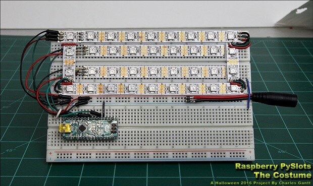

With the circuit figured out, I created a small test board with some NeoPixel scraps I had laying around. I connected two breadboards together, and used one to lay out a square that is connected together as one strip, and another two independent strips. I also added in a female barrel jack pigtail so that I could provide proper power to the strips without overloading the Arduino Nano.
With the development setup built I was able to successfully able to combine the two Arduino scripts into a single script that allowed me to run the Ambient Chase animation when the game is powered up, and then quickly switch to the White Strobe animation when a win is detected. To do this, I attached an external interrupt to the Arduino Nano’s digital Pin 3, which is where the Atmega 328’s interrupt 1 is connected. Then all three NeoPixel strips were connected to the Arduino Nano’s digital pin 6. The full code is below.
