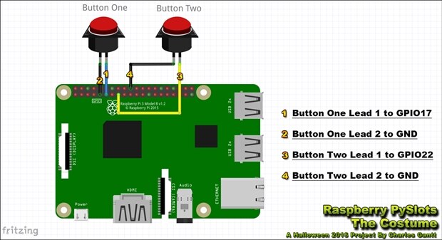

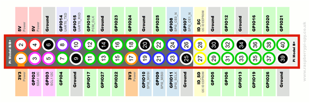

The game has two key buttons for gameplay. The left arrow initiates the “spin”, and the up arrow is used to increase the “bet”. The game also uses the escape key, and the enter key, as well as the right arrow, but they are more for menu navigation, so I am not too concerned with them being broken out to physical arcade buttons. I plan on keeping a wireless keyboard in my backpack when showing off the costume at parties, so I can use it to start, and restart the game. Looking at the Raspberry Pi 3 pinout diagram above, I will map GPIO17 to the left arrow key, and GPIO22 to the up arrow key.  The ground pins located at board pin numbers nine and fourteen are used as the ground for each button. The diagram below should clarify this layout some.
As you might have guessed, I am using the buttons to pull their respective GPIO pins down to low when pressed, and some of you might be wondering why I have not added in any pull-up resistors. The answer is that RetroGame enables the internal pull-up resistors for each pin I map in the program’s configuration file. By using the internal pull-ups I am able to reduce the components needed, and make the circuit as simple as possible.

LEFT       17  # Joypad left
# RIGHT     19  # Joypad right
UP        22  # Joypad up

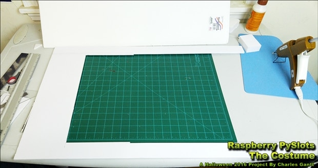

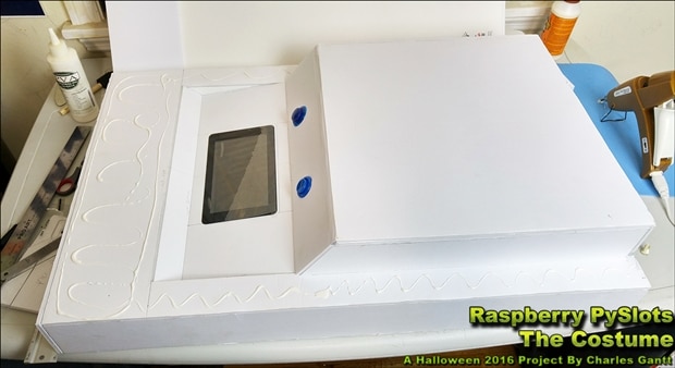

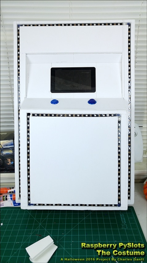

The Slot Machine Body

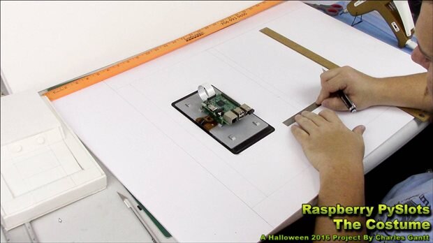

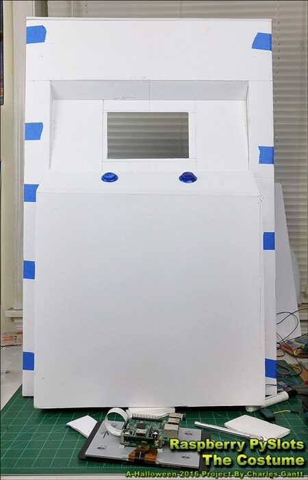

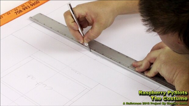

To be perfectly honest with everyone, I did not document the build process of the slot machine body other than a few photos here and there. This was because I knew I did not have enough time in this post to cover a 5-hour build step by step. I will share a few photos of the process though.

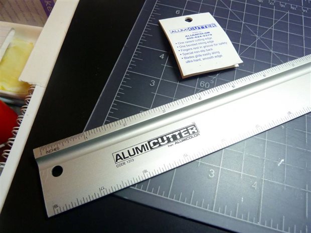

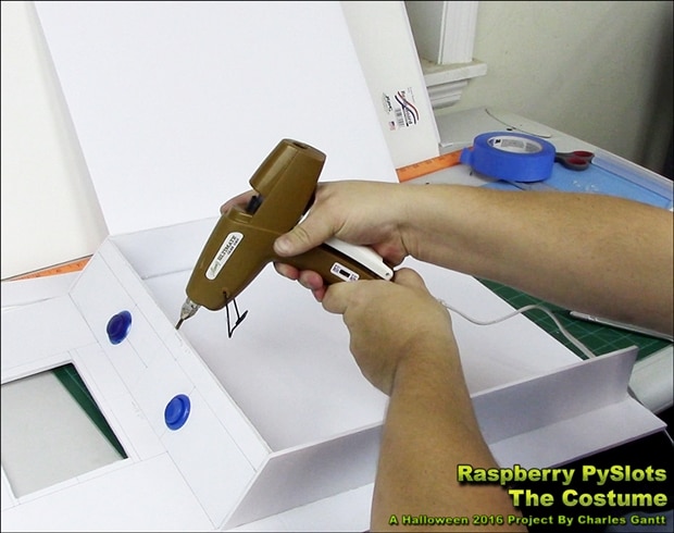

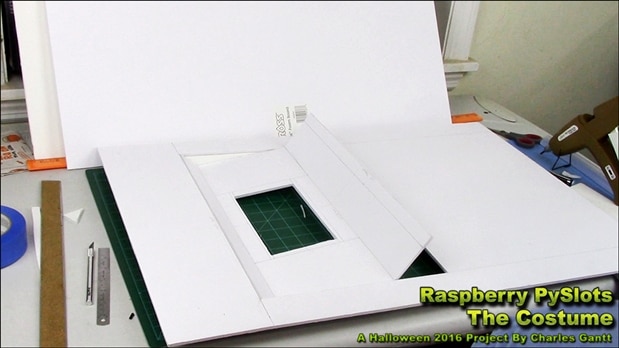

I started out by laying out all of the various cuts that were needed to get the desired shape I needed to build the face of the slot machine. Here you see me laying out where the Raspberry Pi 7-Inch Touch Screen will be located. I used a variety of different rulers, scales, and squares to build the machines body.
Here you can see me making the various cuts in the foam core that I laid out the machine’s face on. The reason I used foam-core was because it is very lightweight, cheap, and versatile for this kind of build. Since foam core is comprised of a piece of styrene foam that is sandwiched between two pieces of cardboard, it makes building angled 3-dimensional shapes fairly easy. In my case I needed the area where the screen sits to be recessed back into the body of the machine, and I was easily able to achieve this by making a series of “half cuts”. Half cuts are basically a cut that slices through one cardboard layer as well as the foam layer with the second layer of cardboard remaining uncut. This allows you to make very crisp, precise bends, which can be locked into place by filling the “V-Groove” that forms between the cut with hot glue and letting it set.
You will also notice that I am using a special ruler that is designed for this kind of work. It’s called an Alumi Cutter, and is designed to keep your fingers safe, and the blade at 90-degrees when cutting foam core. I have several of these in different sizes, and can not even guess at how many times they have saved my fingers when cutting foam, fabric, and plastics with an exacto or box cutter. I highly recommend picking one up if you are going to be making a lot of straight cuts with a razor sharp knife.

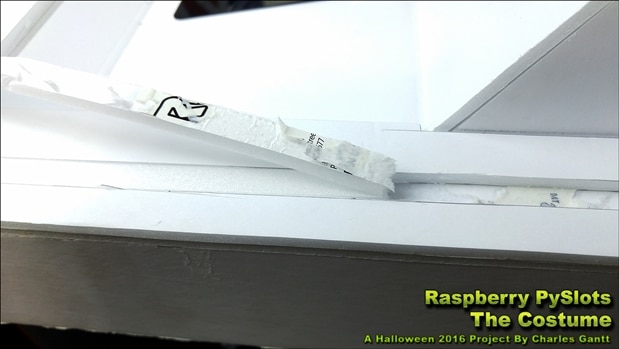

Here is a good example of how half-cuts are so useful when working with foam core. I made a half-cut at the top of the recessed section, then flipped the foam core over, and made two half-cuts from the back. Then I made a final cut all the way through the bottom, and down each side. This allowed me to “bend” the foam core to create a 3D profile that I then locked into place with hot glue. You can also see the cutout for the touchscreen.

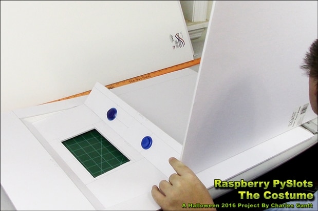

Here you can see that I mounted the two arcade buttons I scavenged from an old project. I wanted to use separate colors, but these are what I had to work with. If you are curious about what I am doing with that full sheet of foam core, I am just eyeballing the length I will need to cut the sides of this box at.
Once I got the sides cut and installed, I was read to mount the first layer of the front of the machine. I doubled up on this layer, as well as on the sides and top of the face because I will be cutting out slots the thickness of a single sheet to recess LED strips into the surface. A good hot glue gun is paramount to working with foam core and remaining sane. I personally like this model from Aleen’s because it has dual temperature settings, and several interchangeable tips for more precise control of the glue application process.
With the basic shape of the slot machine finished, I moved on to reinforcing areas of the body that might experience wear or stress during my night party hopping. Here you can see that I have already covered most of the front face with a second sheet of foam core, and in this photo, I am readying the surface of the rest of the front with PVA glue for a second layer here as well.
Here you can see the piece of foam core I cut out to reinforce the top and sides of the front face of the slot machine.

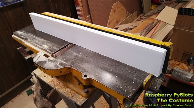

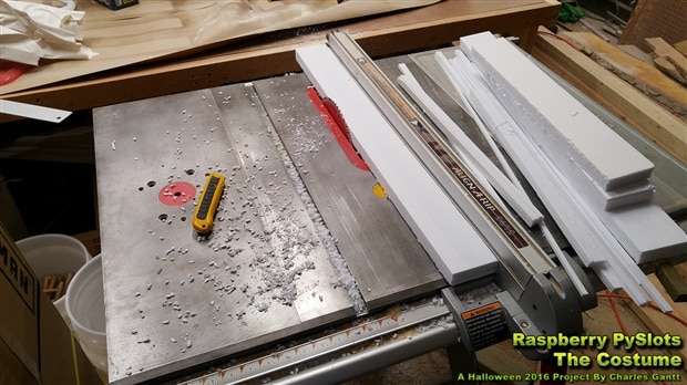

When I reinforced the sides, I made them extra thick, and in doing so, they were not all the same height. To fix this problem, I took each stack out to my woodworking workshop and used my 60+ year old Rockwell jointer to true up one side.
With one side now flat, straight, and square, I was able to true up the other side on my table saw. This did create a lot of fine foam dust, so if you attempt to do this yourself, wear a respirator.

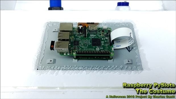

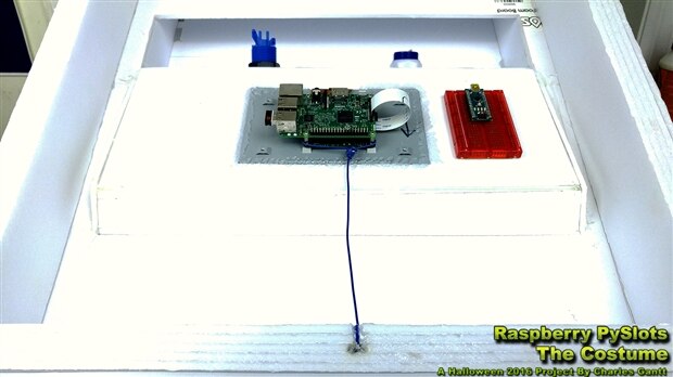

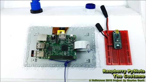

Installing the Electronics

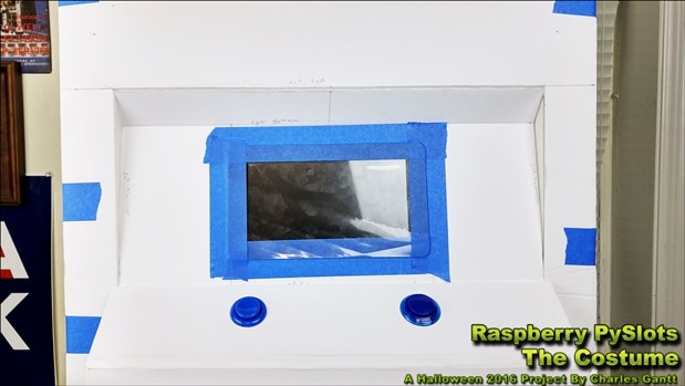

With the reinforcements on, I used tape to hold everything down nice and tight while the glue dried. Surprisingly, archival-grade PVA glue dries incredibly fast. I think the total drying time was less than 10 minutes before I was able to remove the tape and move on with installing the LCD.

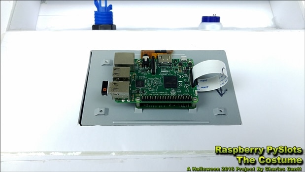

I used more painters tape to hold the LCD in place, and then flipped the slot machine over so that I could secure the LCD to the body using hot glue.
As you can see, the Raspberry Pi 7-Inch touch screen fits nice and flush when placed in a single sheet of 5mm foam core. I cut the hole out so that it would be a very tight fit on purpose, but I do recommend that you leave one edge a little wide so that there is some wiggle room in the event that you need to pull the screen back out. I also suggest when placing the screen in, you place the edge with the orange ribbon cable in first, so that they do not get pinched during the install.
To hold the LCD in place, I used a generous amount of hot glue. I know what you are thinking: “That is going to be a pain to remove when the project is over.” but I have a easy solution for removing hot glue easily. You simply have to freeze it using a can of compressed air which you turn upside down. The glue becomes very brittle and it simply pops right off.

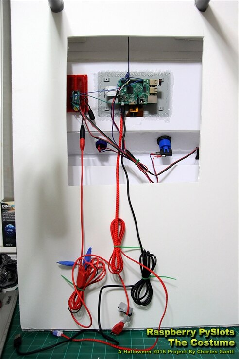

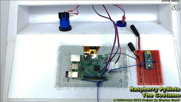

With the screen in place, it was time to start adding in the rest of the hardware. Since I plan on reusing this hardware in a desktop arcade style slot machine, I chose to just glue in an old small breadboardsmall breadboard, and wire everything up temporarily. Here you can see that I have added in the Arduino nanoArduino nano, a barrel jack, and a 600uF 60V capacitor to balance out the input power for the NeoPixels as Adafruit suggest.
Now we need to wire up the arcade switches, and to do that I crimped some female spade terminals onto the ends of some wire, and wired the switch into Normally Open mode. I really appreciate the higher quality arcade buttons that use these removable micro switches, as they make wiring things up very easy.
I soldered common female dupont jumper wires to the other end of the switch wires and then connected them to their respective pins on the Raspberry Pi. See the button wiring schematic earlier in this post for more information on where those wires go.

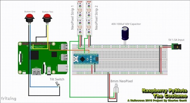

Here is a diagram of the final circuit for the complete whole project.
I know someone was wondering what the blue wire that was tied around the Pi 3’s standoffs was, and the answer is that it is a simple safety cable. While I am sure the hot glue will hold the screen in place just fine, a little insurance never hurt anyone.

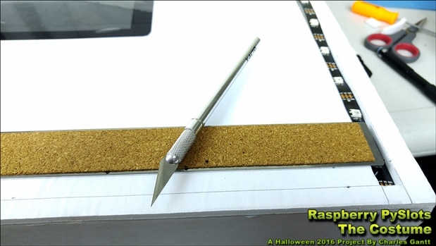

Installing the NeoPixel Strip
Now that the internal electronics are installed and hooked up, I needed to move onto installing the NeoPixel Strips on the external face of the slot machine. Early on I decided to recess the NeoPixels into the face of the machine, and the easiest way to do this is to make two parallel half-cuts in the foam core that is slightly wider than the LED strips. In my case, the strips were 1cm wide. Once the cuts have been made, you can simply pull out the thin strip you created, and you are left with a 5mm deep slot to place the LED strips in.

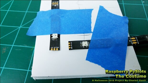

One important thing to remember is that the dimensions your LED stips have to be spaces will be determined by where the solder points are on the end of each strip. It’s hard to see, but you can see that the last LED on the strip is about another strip’s width from the end where the solder points are. This allowed me to make the next cuts with the top stip overlapping the unplaced strip by about 1cm. This makes wiring the strips together very easy, and in my case, it worked out perfectly for the spacing that I needed for symmetry.
With all of the slots cut out for the NeoPixel strips to recess into, it was time to begin wiring up the strips. Since NeoPixels need a 5V, Data, and GND line, I am using three of the wires from 4-Conductor RGB LED wiring. I buy this stuff on Ebay in 200’ quantities whenever I need a few feet. It’s cheaper than any other 4-conductor wire on the market. I do not have a nice pin crimper, so I just solder the male header pins straight onto the wires.

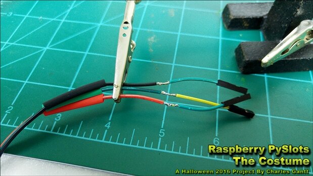

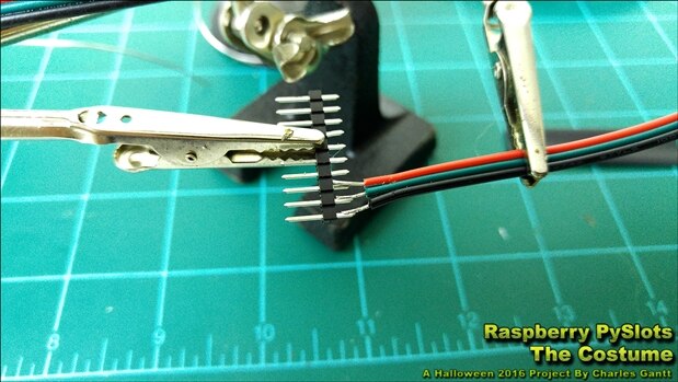

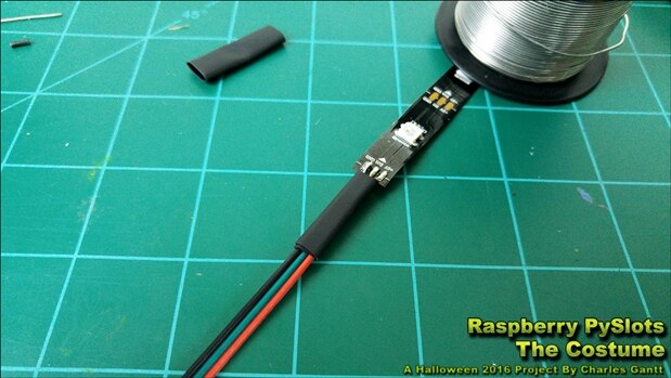

Once the header pins have been soldered on, I use a pair of flush cutters to split them apart. If the pins will be located close to to other components or pins, I will sometimes heat shrink them at the connection, but in this case it was not needed.

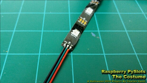

Next I needed to solder the wires to the actual NeoPixel strip and that is pretty straight forward. One tip I can offer would be to not keep the heat on each pad for very long. I have soldered hundreds of these strips over the last few years, and have seen many joint failures from the pad lifting due to too much prolonged heat. I like to pre-tin the pad, and the wires, then use as little heat as possible to make the connection.
One other quick tip I can offer is to use the grid lines on a cutting mat to quickly and easily cut heat shrink tubing to precise inch long sizes. On most cutting mats here in the US, the grid is based on 1-inch divisions.

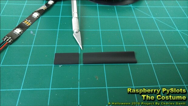

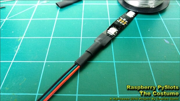

One lesson I learned after installing hundreds of LED strips in different haunted houses is that their weakest point is where the solder connection is. It does not take very much stress at all to rip a solder pad from the strip. To alleviate this, I add two heat shrink tubes to the wire, shrinking one overtop of the other.
Then I slide a third heat shrink tube over the LED strip by about ½-inch. This creates a very nice stress relief, and protects the solder points from shorting out. It does use a little more heat shrink, but it is worth it in the end.

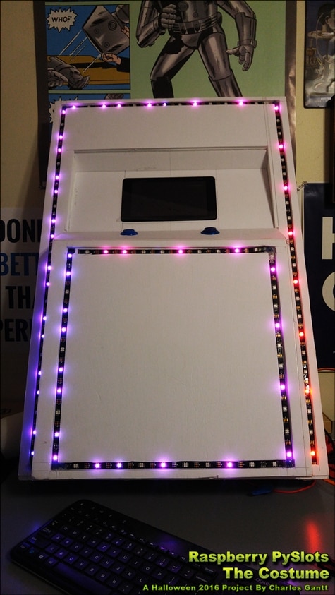

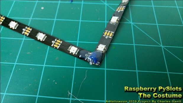

One of the most tedious parts of this project was soldering up the NeoPixel strips into squares. To get the angle right, and ensure proper spacing between strips, I used tape to affix them to a scrap piece of foam core, then soldered short wires from point to point. Note that I do have these two strips positioned incorrectly. I have the Digital Out pins on each strip facing each other. The bottom, horizontal strip, should be flipped around so that the Digital In pin can be connected to the Digital Out pin.
Once each corner joint was complete, I potted the corner using hot glue. This acts as a strain relief, and helps keep the corner square.
With all of the NeoPixel strips built it was as simple as removing their adhesive tape’s backing and pushing them into place.
Now connect the NeoPixel strips to the Arduino like so.
A quick test using the Rainbow Chase function showed that they are all working. Both strips run from the same pin, so the animation is the same, but I have the direction they chase in reversed by the way I mounted the smaller square.

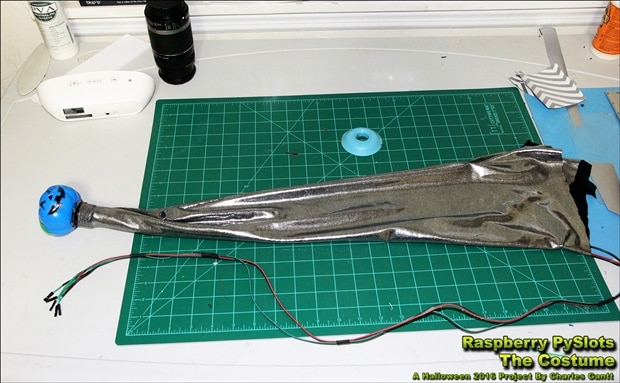

Building the Slot Machine Arm Sleeve
You might remember from my first post that I purchased a few yards of this shiney silver metallic stretch fabric with the intention of using it as a sleeve on my left arm. This combined with the tilt sensor, and a cheap halloween childrens flashlight will create the pull arm for the slot machine. I will be the first to admit that sewing fabric together is not one of my strong abilities, much less sewing it so that it conformed to my arm. So I enlisted the help of my girlfriend who is a professional fiber artist, and general all around maker. Using her sewing machine, and seamstress skills, she quickly had the sleeve crafted, and there was enough material left over for her to make jokes about sewing me a pair of short shorts together….
I did not get many photos of her sewing the sleeve together because I was busy working on the rest of the project, but here it is in all of its glory. The sleeve fits over my arm quite well, and the pumpkin flashlight is fastened into place. The sleeve will go on my arm before I put a black t-shirt on, thus hiding its open end. So let's look at how I built the electronics into this piece.

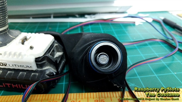

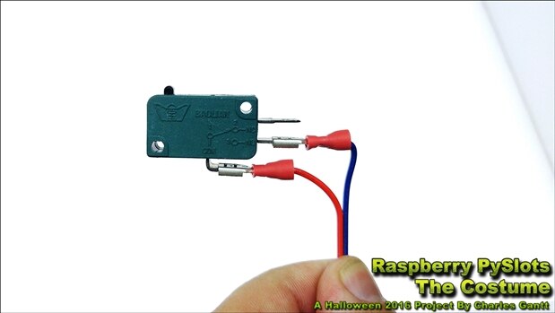

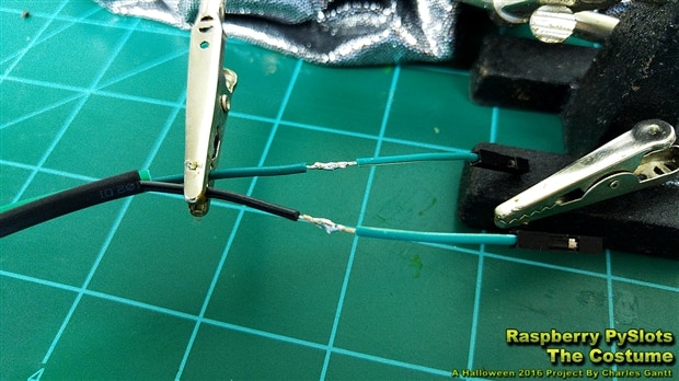

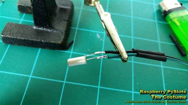

As I mentioned earlier, I will be using a simple tilt switch to control the spin of the slots wheels. If you are unfamiliar, a tilt switch consist of a plastic tube that is encased in a metal housing. Inside the tube is a small steel ball. Then the tilt switch is tilted down, the ball makes contact with two contacts, and completes the circuit. Installing the tilt switch was as simple as soldering two wires to its leads, and adding heat shrink.
On the other end of the wires I soldered on two Dupont female jumper ends. These will plug directly into the Raspberry Pi 3’s GPIO Pins.

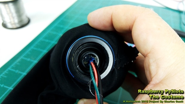

The pumpkin flashlight originally came with a very dim incandescent christmas light bulb, and was powered by two AA batteries. All of that had to come out, and I added an 8mm NeoPixel LED so that the pumpkin could still light up. I did have to drill the hole out, and I just happened to have a 7mm drill bit laying around. I was able to wiggle it a little in the hole and that widened things enough for the 8mm LED to fit snugly inside.
I forgot to take photos of the 8mm NeoPixel being wired up, but I did remember to take a photo of it hot glued into place.

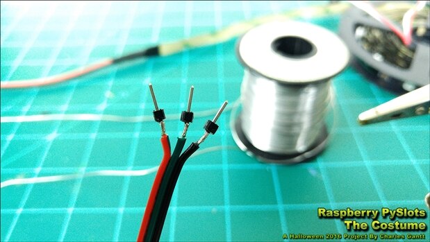

On the other end of the Pixel wires, I added three more DuPont female jumper ends so they could be plugged into the breadboard using some spare male header pins I had laying around.

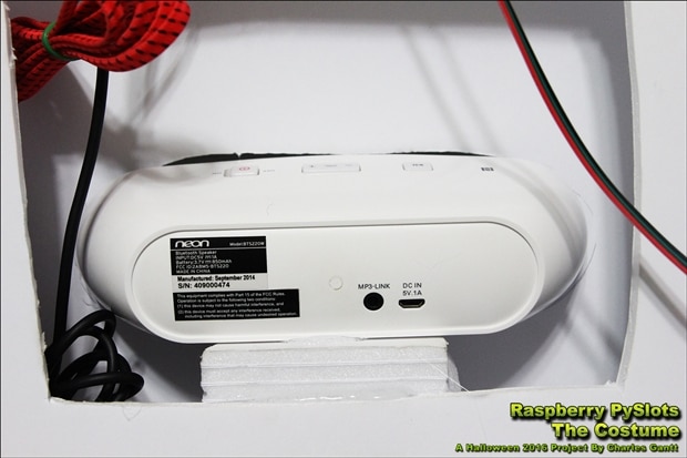

I absolutely ran out of time to install the Bluetooth speaker the way I wanted to, so I simply hot glued a stack of foam core together, then glued it to the front panel from behind. This gave me a ledge to place the speaker. A rough hole was then cut out, to allow the sound to pass through. Don’t worry though, I covered this ugly hole up with something.

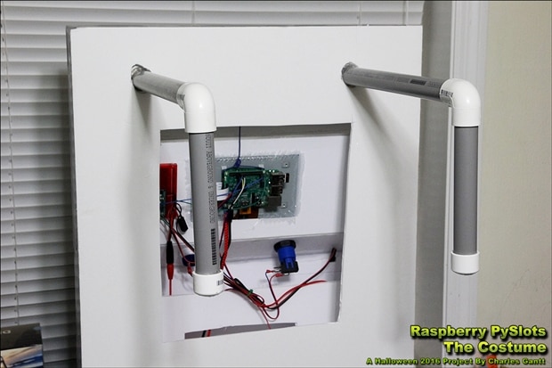

One of the final parts of the build was to fabricate a solution that would easily hang the slot machine from my shoulders. A good friend of mine is a professional cos-player, and he suggested that I build a shoulder harness out of PVC pipe, and that is exactly what I did. This used about 5-feet of PVC, 2 elbows, and two caps. I mounted each arm to the slot machine by building two stacks of foam core, then drilling a ⅞-inch hole in each with a Forstner bit. I then hot glued them into the holes. This setup is surprisingly comfortable, even with both battery packs inside the slot machine, and it holds the machine at the perfect height for people to play while I am walking around.

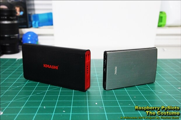

Here is a quick shot of how I am powering the Raspberry Pi, the Touch Screen, and the Arduino Nano / Neo Pixels. The striped red USB cable powers the screen, via a 2.4A port on a battery bank, while the black USB cable powers the Raspberry Pi 3 from a 2.4A port on a second battery bank. The solid red USB cable provides 5V 1.5A to the breadboard which powers the Arduino Nano, and the NeoPixels.
This is the two power banks I am using to power the costume. The KMASHI is a 16,000mAh 2.4A / 1.5A battery bank while the Royal is a 10,000mAh 2.4A battery bank. I picked both up from Amazon, and I think I spent $15 on the KMASHI, and $10 on the Royal.

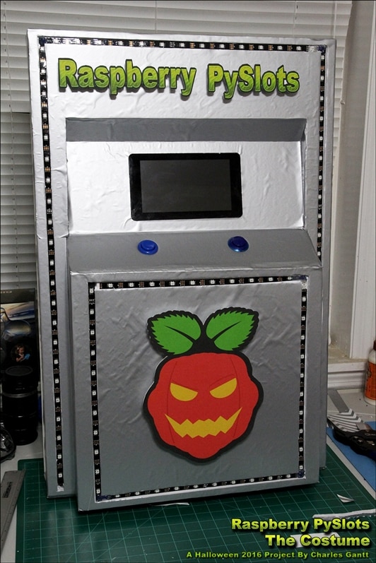

Finally we have a shot of the front of the slot machine after some decorations have been added. I originally planned on designing custom graphics for the machine, but as I mentioned at the beginning of this post, ran into printing issues. So I did the next best thing, and wrapped it in silver wrapping paper, and printed some logos that I then mounted to foam core and cut out. Both of these are glued to the slot machine body with 1cm standoffs behind. I am using the Halloween Pi logo to cover the ugly hole I cut for the speaker.
